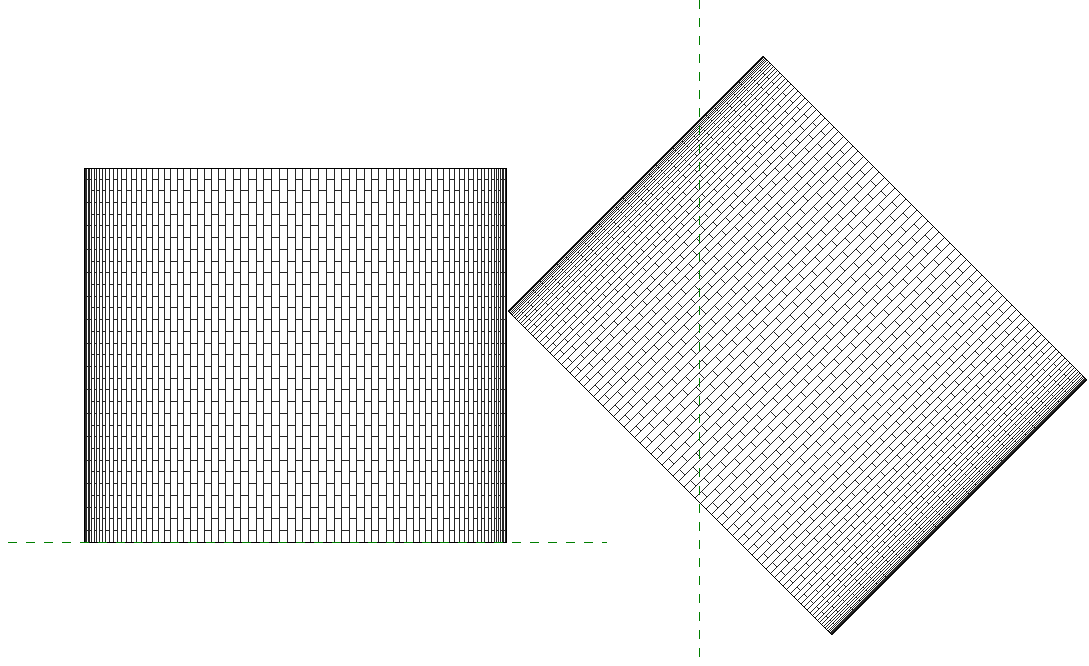

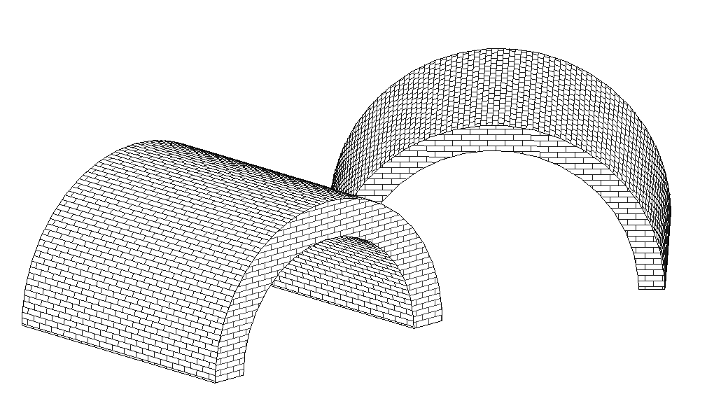

Wed, Sep 4, 2013 at 10:44:57 AM | Rotate model hatch on curved roof
I have always found model-in place materials to be somewhat of a problem.  The material is applied based on the work-plane used.  In the attached view, the extrusion on the left used the horizontal plane you see.  The extrusion on the right used the vertical plane then I rotated it afterwards.
I hope this points you in the right direction.
