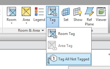

i m using a 2012 version of revit. and i have design a little complex building in it. when i take sections, its very confusing due to its complicated model.i cannot make out which room is which.i have to go back to section line in plan to understand it..As there is absolutely no time left, and i have to submit this now, is there a way to get the room names in sections? i have alredy placed rom tags in plan. can a section label it according to room tags in plan??

use tag all not tag command
Fri, Aug 30, 2013 at 7:39:26 AM | Room name in section
Just tag the room like you did in plan views.  ROOMS must be on!
