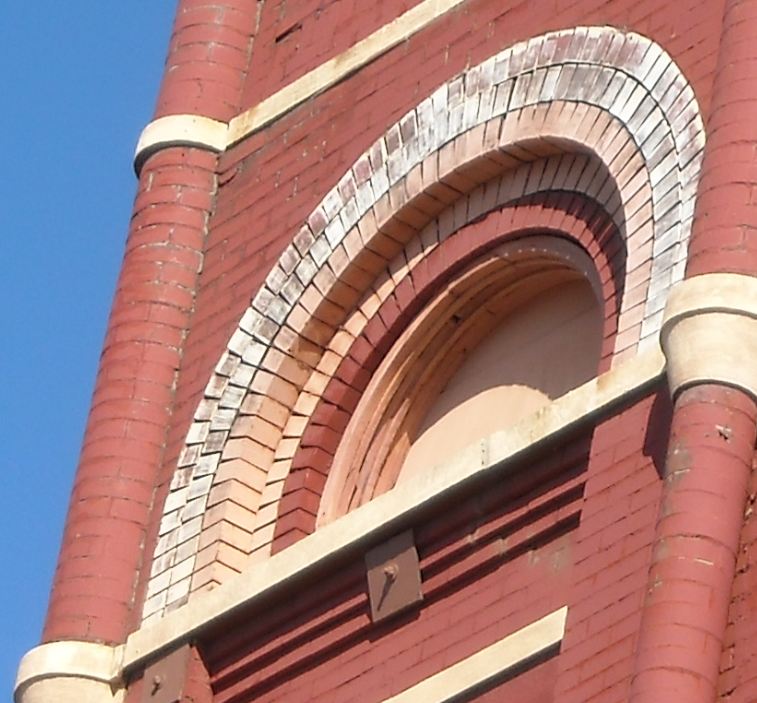

Hello all,
I'm working on a renovation project and I'm modeling an existing building.  I would like advice from you more advanced users on what technique you would use to model the decrative brick in this building.  Please see the attached photo.  I'm not sure if I should use multiple walls or if I could create a sweep of somesort.  Not sure if I can even do a sweep that's arched.  Any advice is appreciated.
Thu, Aug 29, 2013 at 2:28:51 PM | Opinions on how you would model this?
I think the arch is a family - probably window.  The horizontals are wall sweeps.  The round pilasters would be a family with the stone at the horizontal sweep built into that family.
