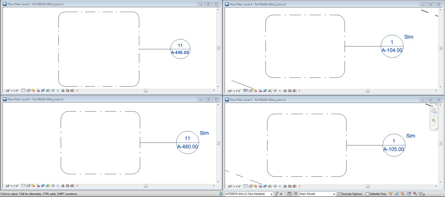

I apologize in advance for the long post but we are experiencing an issue that seems common enough that Revit should offer a solution.
Assume a scenario where we are designing an apartment building that has 30 floors (all slightly different) but has a number of bathrooms that are the same or simliar. We want to do callouts for the bathrooms on one floor and "simliar" tags on all the other floors. Creating a new referenced callout for every "similar" instance in the project is really not a viable option.
If we do a detail callout of the original bathroom plan, we can create one referenced callout on the floor above and copy/paste it to all subsequent floors. This would be a great solution but because detail plans will not allow us to add interior elevation marks (required) to the original bathroom callout it appears we cannot use detail callouts.
If we do a floor plan callout of the original bathroom plan, elevation marks work fine but after creating a reference callout on the floor above it seems it cannot be copied to to subsequent floors without changing the reference information.
Our solution thus far has been to create a drafted detail group of a fake referenced callout and copy it to all the floors. While it saves countless hours of work, its obviously an imperfect solution.

Thanks for your quick responses. I believe I am doing exactly what you're saying. The issue occurs when I try to copy to other floors:
On Floor 2 I make a floor plan callout: View > Callout > Floor Plan > (draw callout)
On Floor 3 I make referenced callout: View > Callout > Detail View > Reference other view > (select view from drop down)
I copy to Floor 4 & 5: Copy > Paste > Align to slected views
See attached image. You can see that it works fine when I draw the reference on the third floor but gets screwy when copied to 4 & 5.
For some reason, the floor plan callouts that are pasted do not retain the referenced callout. They automatially change the plan referenced in the callout for on each copied floor. This does not occur when the original callout is a detail callout BUT I need to be able to put interior elevations on the original call out. This only available when the original callout is a floor plan callout.

I'm sorry, your absolutly right.  It doesn't work in 14 and it doesn't work in 12.
I could have sworn that I used to do this.

Thanks for your efforts. Our current solution drafting/copying detail groups of "referenced" callouts is a viable work around. Its just not very "smart".
