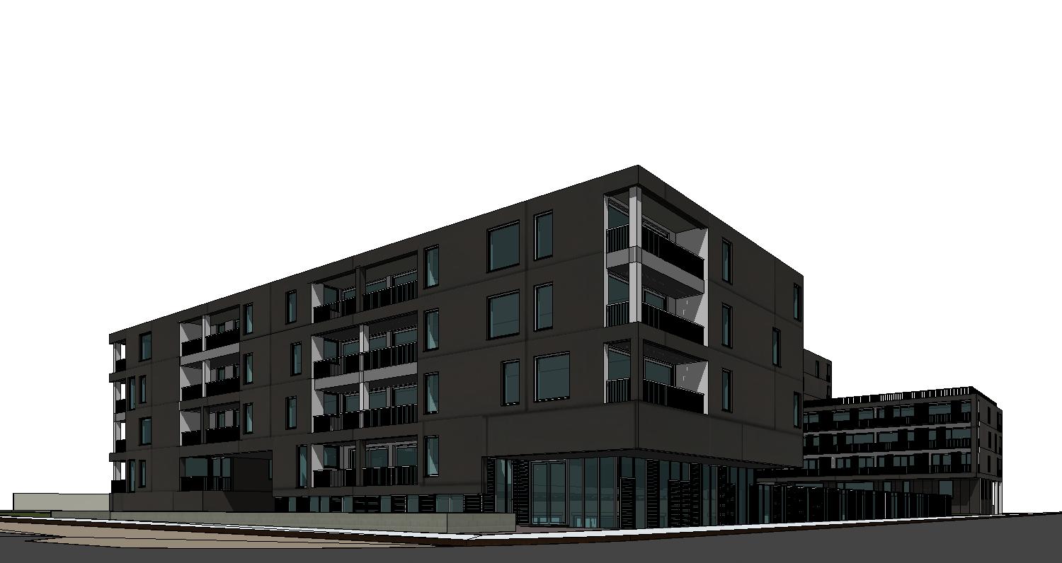

Hi,
check attachment,
when i render in the cloud my material gets scaled way to big.
anyone had this problem and found a sollution?
tnx!

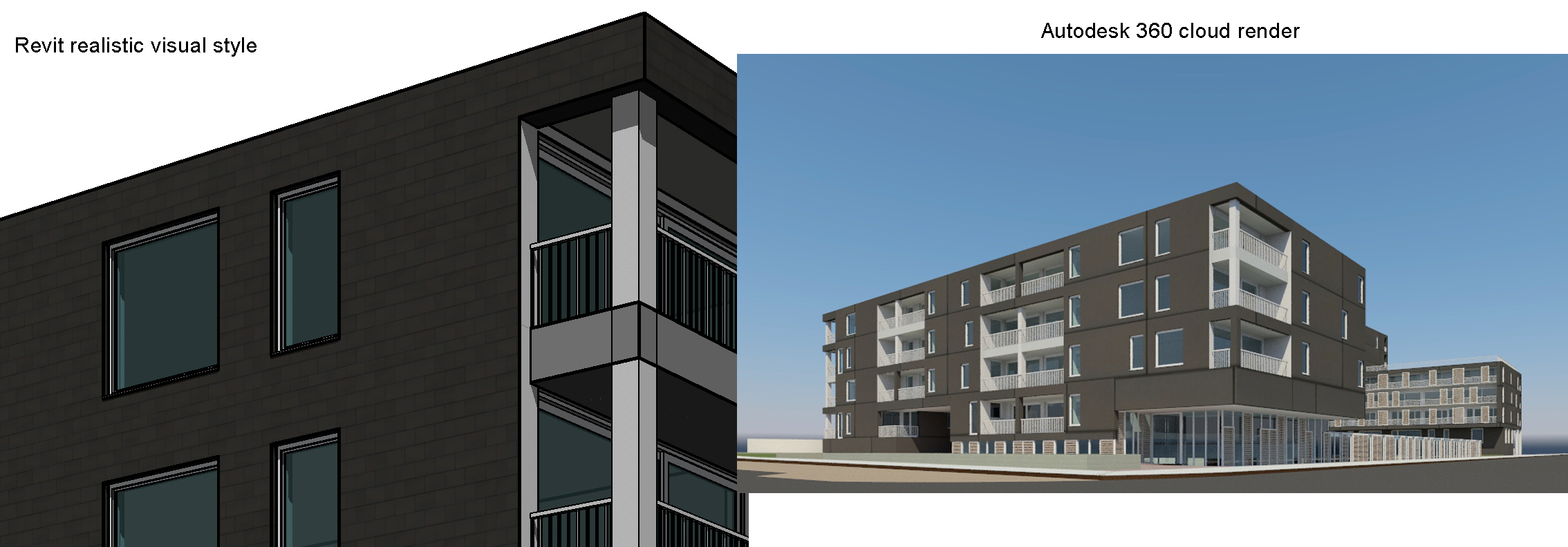

Are you sure that is the same material?  I don't see any pattern at all in your image so it may not be a scale problem.

the big black lines in the cloud render, i dont see how you can not see them,
the texture on the right is about 30 times bigger then the one on the left.

it is my pattern, but,
my walls are drawn floor to floor but they are joint,
the reason the vertical line just keeps going is because the pattern just restarts at each level,
i have attached a image where i have enlarged my texture 30x in revit realistic view, and it gives the same result as my cloud render.
where can i set cloud materials seperatly?
i will look into it but i have never heard of this being possible...
