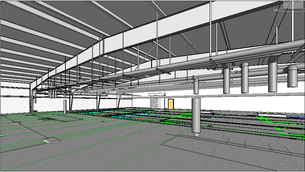

I have done a little of this. Taking on a campus wow. Anyway I have found that 3D is the best way to make this happen, and you will need the use of many workplanes. If you name the work plane, when you use the view tool it automatically snap square to the named plane. Then you can draw all the piping and conduits you like setting elevations etc.

Very impressive drawing.  Having worked with a similar warehouse gut job with completly new utilities added to the structure i can appreicate the amount of work that your image shows and the use to all of those that involved.  I think the architect moved a Gas 3" overhead gas pipe 3 times to fit some architectural ceiling features.
