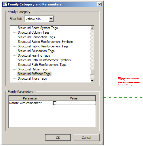

I have created a parametric family from the family template "Structural Siffener.rft".  Works fine when I insert it into a drawing.   Now I want to tag it, no Structural Siffener tag existing so I want to create one.  This is done by creating a new family/annotations/__???__  then I am expecting to find a structural stiffener TAG family template under annotations but none exists.  If I create another type of tag, it wont annotate this family.  If I try to tag it, I get the message "no tag exists for Structural Stiffeners.   Would you like to load one now?"     http://screencast.com/t/qrKrKKZzZ5F
Yes, I would!   Does anyone know how or where a template for this is?

Maybe you just have to start with the generic tag and change the category like I attached.

Yes, that's the answer.  It  works.  Thanks!
