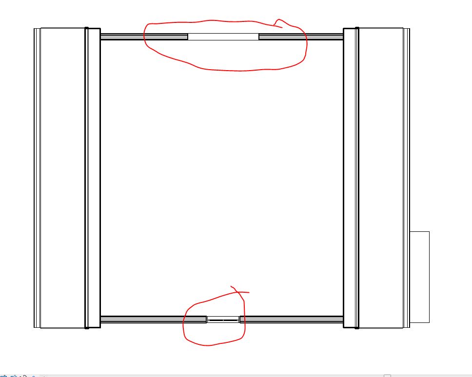

I have been having this problem for a while now.
Sometimes I build a window and when I insert it into my project the cut plain cuts it, but doesn not show it. I have adjusted the cut plain a bunch, but nothing in this regard changes. does anyone know how to fix this, or what Im doing wrong?
Thanks in advance,.
edit: here is the file stripped down. DUDE I CANT EDIT THIS POST!!!!

here is the stripped down version...if this site lets me post anymore..:-(

Im sorry. I figured it out.
the actual 3d parts in the window had their visibility turned off in plan view.
Override Cut Plain on individual objects
