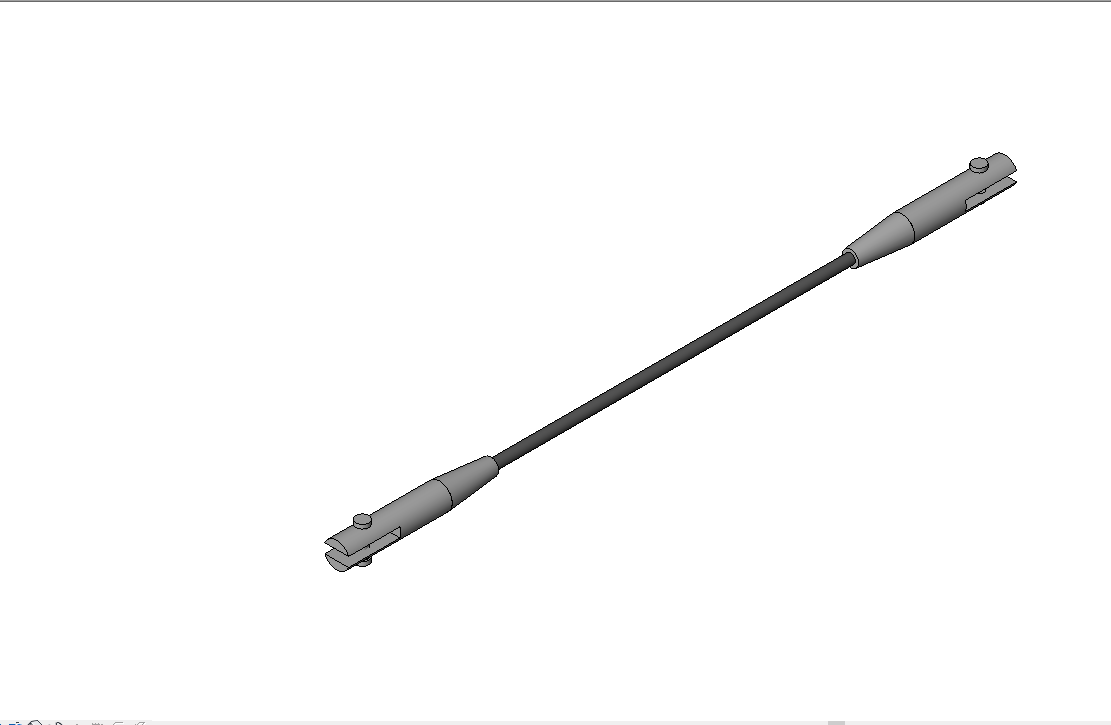

Revit2013, I created the clevis using the height and distance to control the angle of rod cable, now I try to add a buckle as nested family, but I can not make its turn follow the angle of cable.
Please point out what I did wrong on family or nested family.

I didn't open the family but to get 'angles' to react properly you need to use Reference Lines, not Planes.

I open your family and stretched it without any problems. The only glitch came from a reference line shown at the cable angle with a useless angle dimension locked to it. I erased the reference line because it didn't appear that any of the components were locked to it. Personally I think you did a great job creating this family... I learned a few things from it. Thanks for loading it!

Sorry, did't mean to posted and disappear, the only change to practise on revit is on spare time. working in cadd dept every thing are rush rush all due yesterday.
will try to work with reference line like dgcad suggest on buckle. will post the out come later, Thanks all for looking into this.

ok I get the turn buckle to rotate with rod cable, but now I can not create the proper two seperate cables or even void in the middle of turn buckle.
could you direct me why I can draw a reference only in left elevation but not in the other without have to pick reference level or plane.
