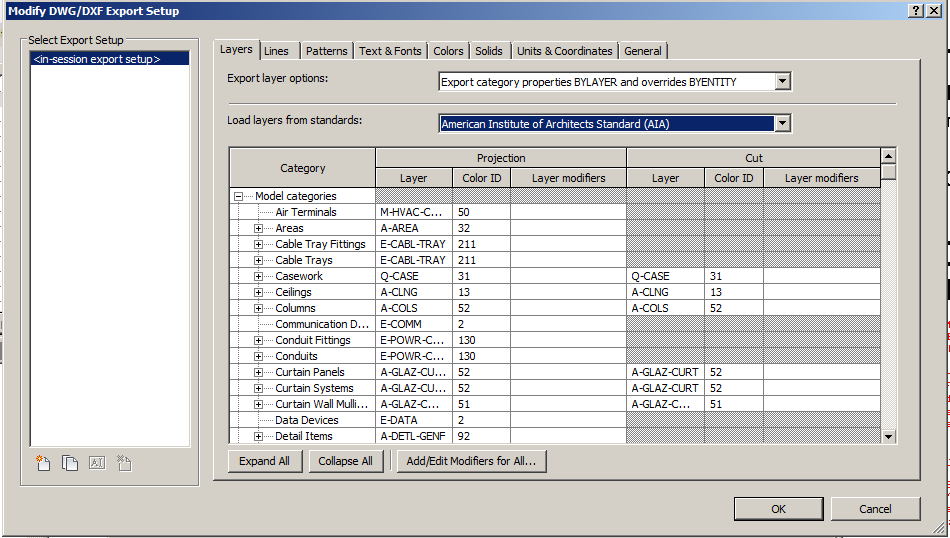

Hello everyone,
Revit lineweights are a little less detailed. If someone has a file with lineweights custom set-detailed, please upload it here.. Thankyou.

Thanks for ur response. Well i'aware of how the layers and lineweights can be custom changed. it might be time consuming to set it all by myself. Just wishing someone would have the project standards  shared like how layers for CAD are obtained. Thanks anyways. Smile

The thing is, where I worked the template was set with lineweights custom to how it would be in Autocad- If u export drawings from Revit to Cad they would have the layers  just the way how the original CAD drawing are dealt with (the layer colours, lineweights and names) . We usually start a new project but "Transfer Project Standards" from older files having all Properties set. So if someone would have a REVIT file only with these settings and share, it would help me a lot. "Shared like how CAD files are obtained" meaning the Layer States. I badly need a Revit file with Object style and Lineweights set.
Wed, Aug 21, 2013 at 9:17:28 AM | Revit templates with Lineweights set
OK - Now you are asking a question that I think makes sense.  When EXPORTING to CAD, Revit uses an established setup which you can control or modiy.  That standard here in the US is based on the AIA standards.  See Attached.

Thankyou. I get it seeing the image.
