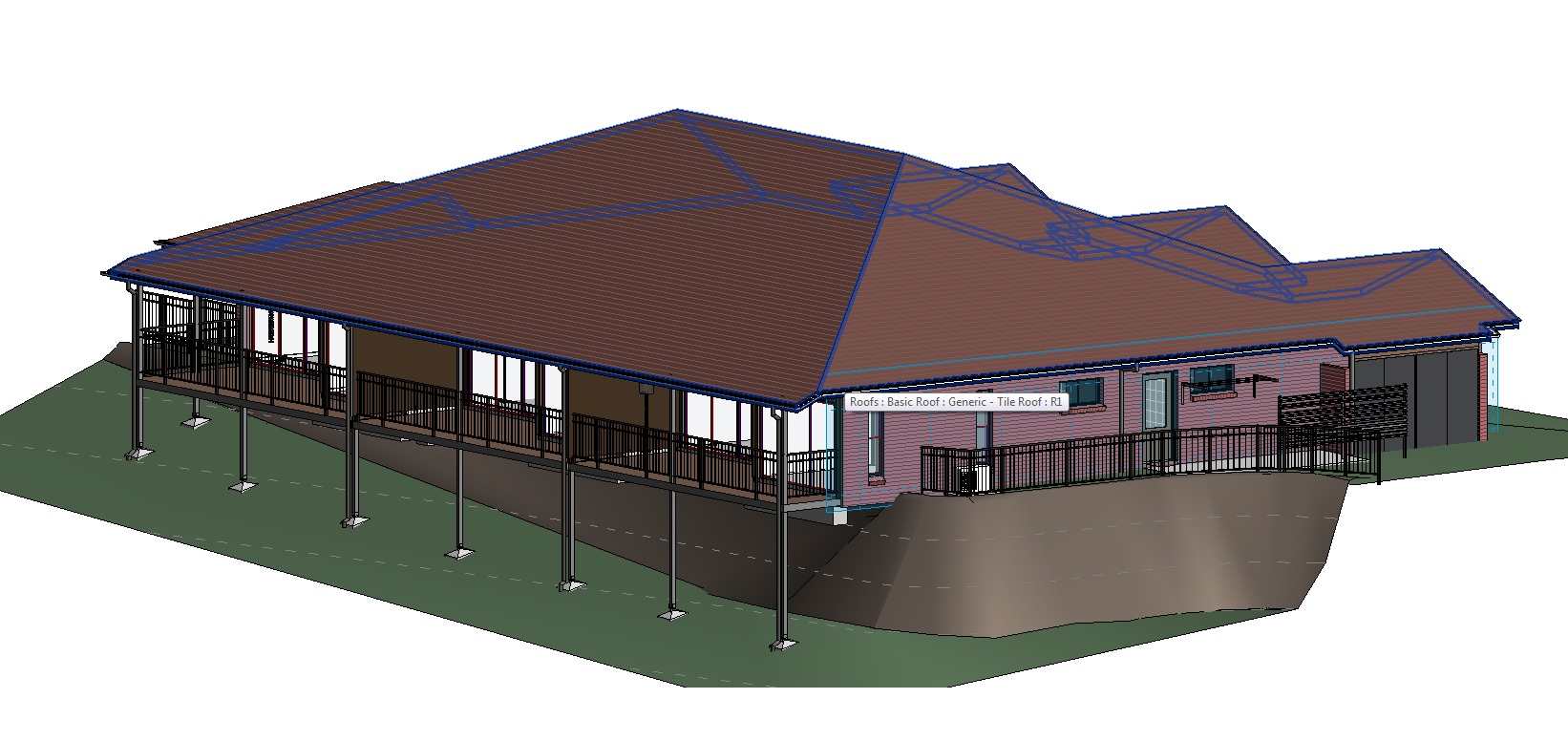

Hi,
Am trying to represent a boulder wall in construction documentation for a residential project.
I have modelled a the topo surface, split it to  show the retaining wall and changed the material.
Its shows as brown in shaded view though I have had no success getting it to display the surface pattern for B&W drawings.
is there a way to apply a surface pattern to topo surfaces?
Regards
Brent
