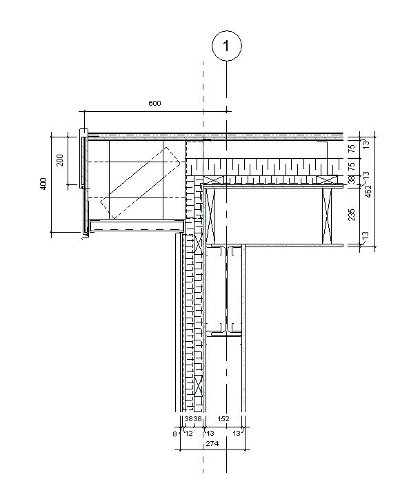

      I'm drafting details in Revit. I've basically created a series of 2D detail iteams as families or set up a bunch of line
styles and draft elements manually. This is for 1:10 and 1:5 scale details. I'm basically using callouts of the model, mostly
section views, and tracing over these. My issue is trying to snap to the model geometry with my 2D annotation. Sometimes
it works, sometimes it doesn't. It depends on the view and the objects inside the view but I can't see a pattern to when
Revit will or won't allow me to snap to model geometry. This is usefull for getting spacing of wall elements and speeds the
detailing procress. Would I be missing something as to why my snaps won't work, or is this a glitch? All snap setting should
be set to default, are their even snap settings to check?
When tring to snap to model grometry usually I get full funtionality or nothing. When nothing everything is always "nearest"
and still won't snap to certains lines from the model.
I can't really upload anything without giving away the whole project file, and its too big.

I made my detail elements through the family editor, with the "metric detail item.rft" template. Things like studs, soffit
section, rigid insulation, window headers, metal deck, plywood, gypsum ect. Then inserted them in the project.Lines Types are for membrames or other
things.
I am tracing over a model view, I am aware of this, and never intend this use that exact detail in another project. Details
are never that close that we can copy/paste section or plan details between projects.
I'm only usuing a drafting view for details that do not appear on my building or wall sections or any other drawing. When
I'm done tracing I turn off the model and only display the line work. Then if need be I dimention the line work. The idea
was I can turn on the model again later for co-ordination purposes of need be, and compare the model to drafted detail.
So is there a problem with trying to snap 2D drafting or "annotation" objects to a model view?
This method was suggested to me by a local Revit training guy my office has been using.
Notes and text and then put on the sheet and I turn the text for each detail into a group so it is easier to move for
organizing the sheet. Helps for practicing the "art" of sheet layout as the senior tech calls it.
This is kinda getting into detailing methods which I did want to ask other users about.
But how about the snapping issue? Any thoughts?
Attached is an example of a 1:10 detail of a roof overhang. "Display Model" property is set to "do no display".

Ok for snapping, lets use the example of a detail line. This line on some model views only (others worked) will only snap to the
perimeter of a wall or roof assembly (view from the model), and not the layers in the middle when in a section detl.
It is as if the snap tool doesn't the interior layers of the assembly, or only parts of it. Like I said it is hard to be specific because the error
seems random. Sometimes a detail line will refuse to snap to anything from the model view, period.
I have no problem snapping to other drafted objects, this always works as expected.

OK - now I understand - you don't mean snaps, you mean align.
You can align with any layer of a wall/roof or floor in an elevation or section view - BUT IN SECTIONS _ ONLY IF THAT ELEMENT IS CUT PERPINDICULAR TO THE ELEMENT...... no "skewed" elements.  The same is true for other cuttable elements.
Good luck with turning off the model and not using it.... BTW - You do know about the linework tool too?

perhaps I have found the reason why it's not snapping lines on certain details. In my case it is only doing it on the upper part of my roof detail section which is cutting on an angle through the roof. Separate details of the same section located lower than the one not working are fine.
whith this in mind is there a fix?
