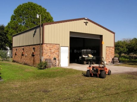

Hello all,
I'm creating a meatl building with brick veneer on cmu at the exterior walls.  Im wondering what the best way to alternate the height of the brick would be.  Stacked walls and have a bunch of different exterior walls?  I'm sure there is a better way of doing this but I've yet to find it.  Could any of you long time user give me a tip on the best way to create this.  i've attached a picture for reference on what I'm trying to accomplish.  Thanks in advance.  Until then I will keep searching....Its sort of like the picture I found but the brick veneer isn't even in elevatio all the way around, say every 10' or so it goes up with 2' high more brick.
Wed, Aug 14, 2013 at 11:48:48 AM | Brick veneer stepping at alternate elevations
Several ways.
I would probably start with a stacked wall with say 2' of brick above the floor line - just to get the walls in place.   This wall would probably include the foundation wall as well - so 3 parts.   Then I would right click on the wall and choose break up.  Now you can go to individual elevations and sketch the wall profile.
The problem with wall sketches is you may have corner wall join problems if the height of the wall at the corner is not the same around the corner.
A second solution is to start with the stack, vertically split the wall at every step point, then break up the individual portions and slide the horizontal juction up/down as required.
