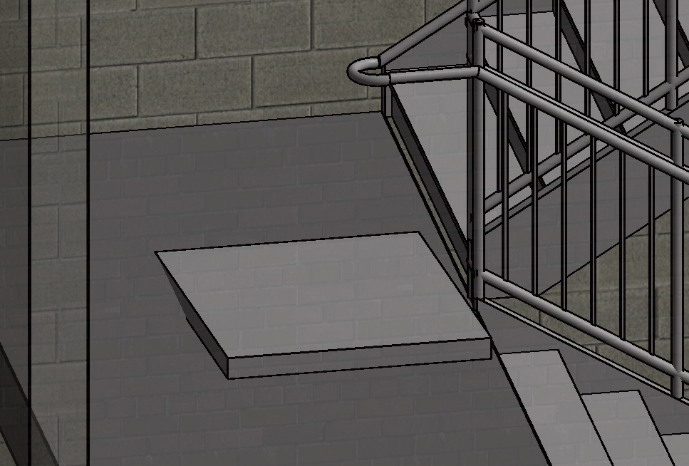

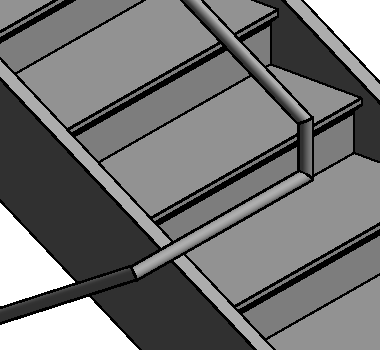

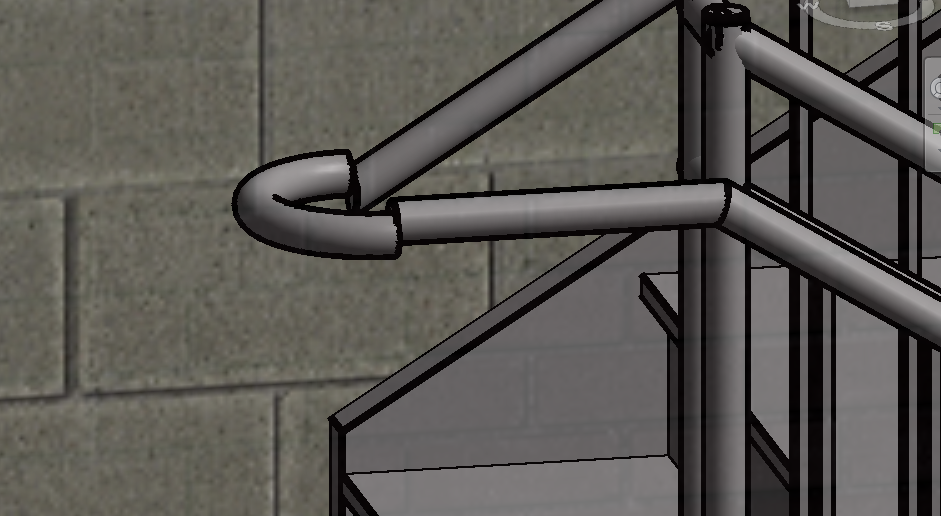

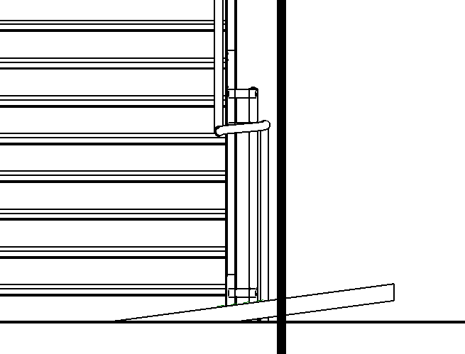

I am attempting to make custom hand railing in a stairwell but I can't get the wrapped areas to line up because the handrails from each level don't end up the exact same height at the landings. I have the main railings hosted to the stairs while the connection piece is independent. I've attached some screen shots to give an idea of whats going on. With no host, I can't get the railing to slope. You can see in the first image how the piece doesn't line up. If I host it to a ramp that is at the slope I need, the railing gets the angle to connect the two railings shown in the other two images but I don't want the ramp there. Is there a way to get this railing to slope without the ramp? Is there a way to delete the ramp while leaving the railing at that angle or is there a way to slope the railing independently? I've looked all over and the only answers to railings I get is to host it but I none of the hosts provide the angle I need.

There is no way to do this short of model in place.  We use Revi's automatic "add vertical connector".
