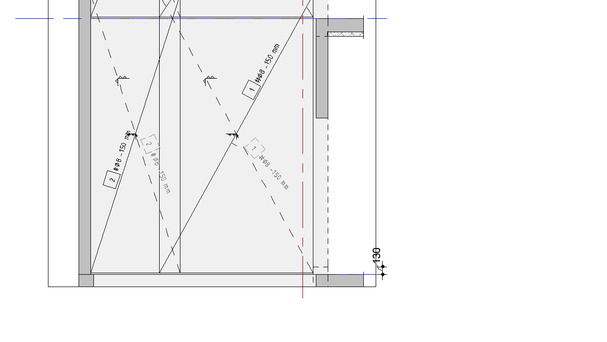

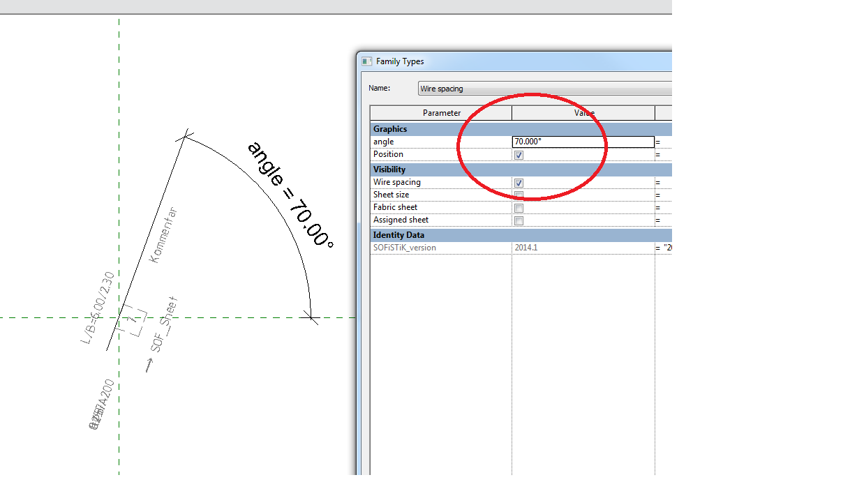

I have faced proble which I dont know hot to solve
I have been working with reinforcement and I neet to present fabric sheet reinforcement. The problem is that there are two layers of fabric sheets which needs to be shown (exterior/interior). SFR tags will automaticaly snap to element (user can define where exatcly:diognaly;minor/major axis). It works ok if I add tag to one direction, however there is no way how to snap tag to other diognaly. Only solution I have found right now for my problem is creating tag family with agnle parameter, which alows me manualy adjust tag. Any sugestions.
