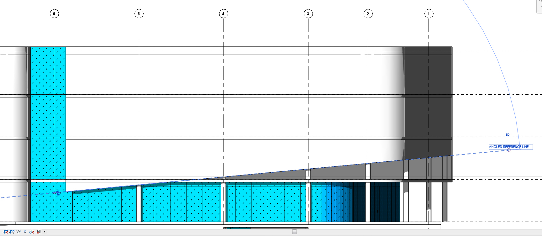

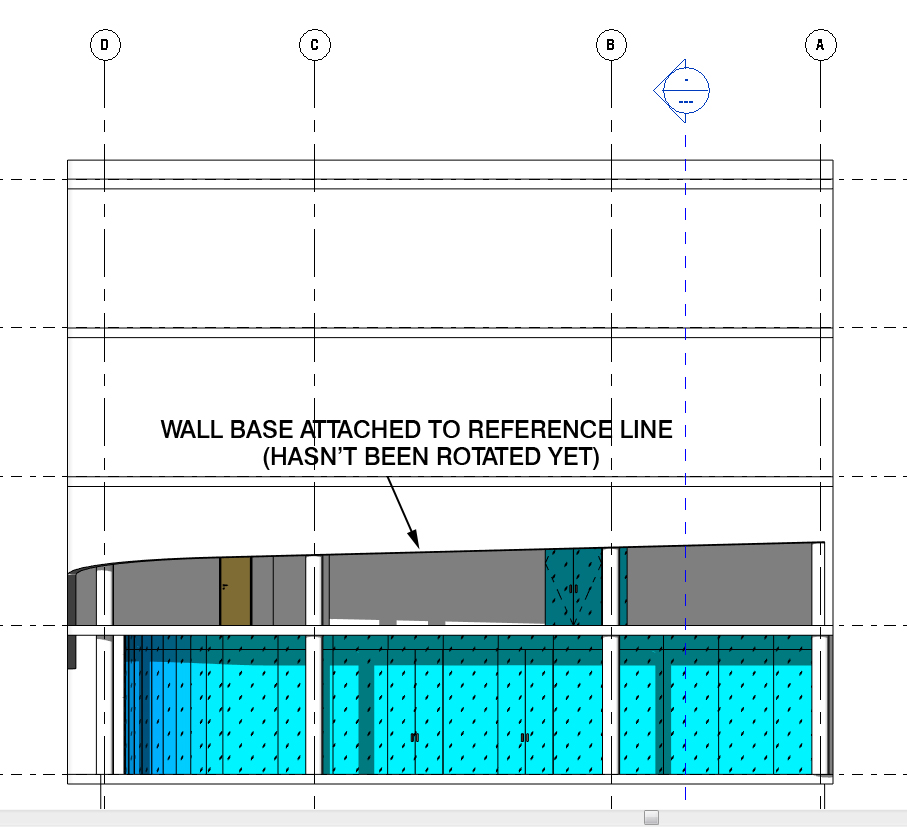

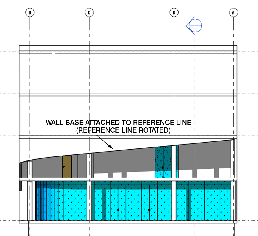

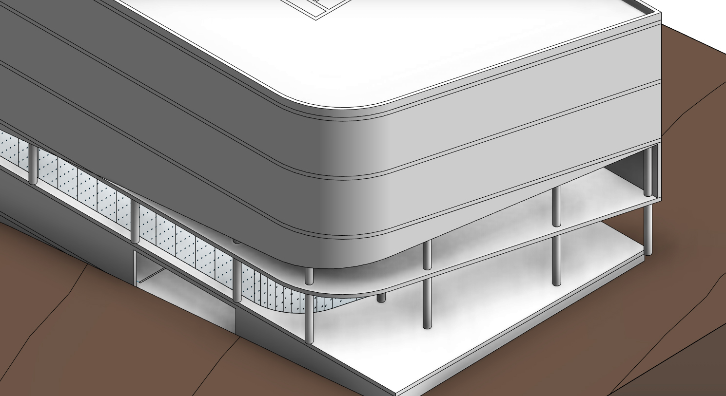

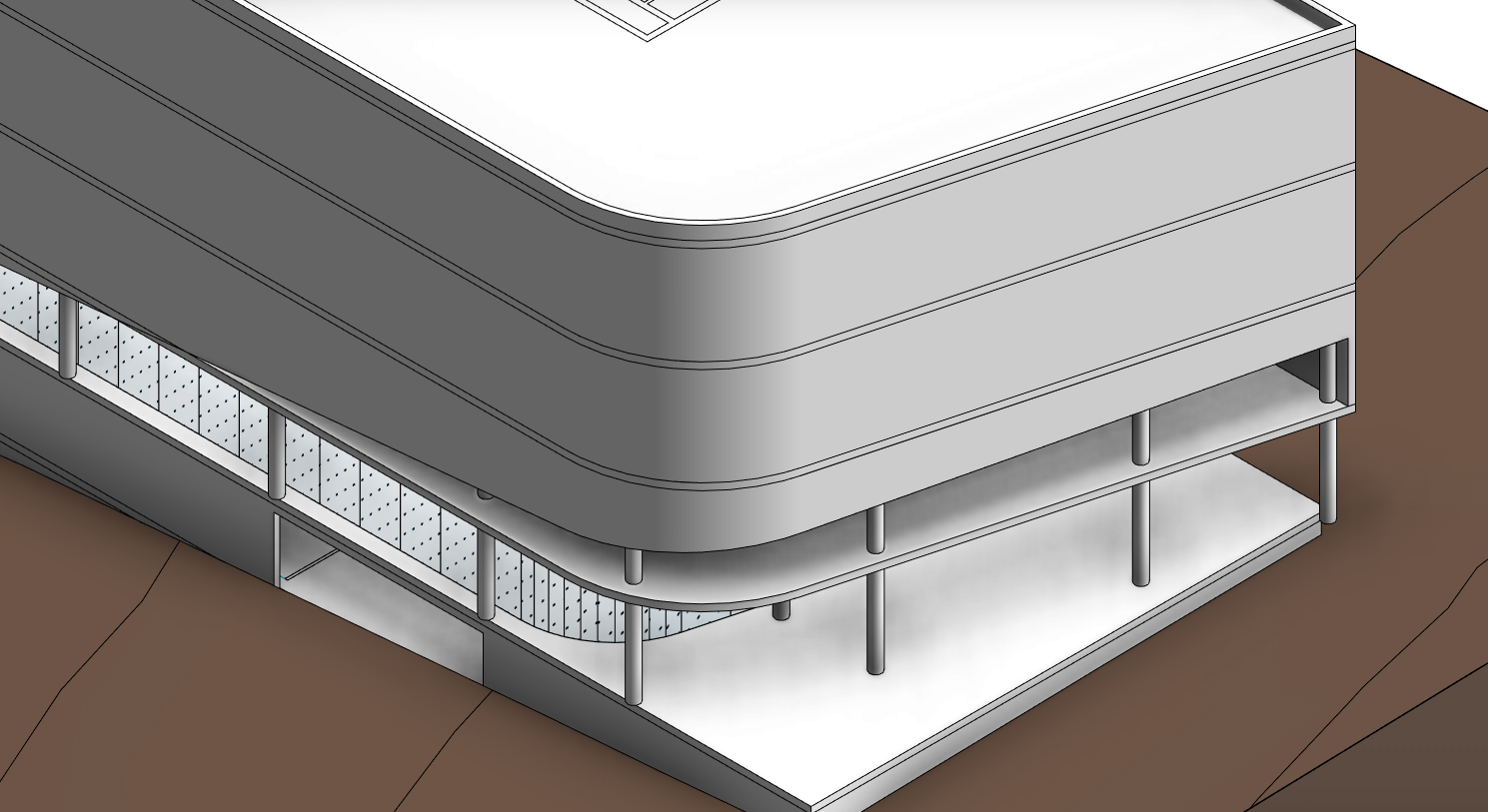

Is there a way of attaching a wall to a reference line via an object list (as opposed to picking the reference plan in your view)? My problem is that I have drawn an angled reference line in one view and rotated in a perpindicular view - effectively angling my reference plane in two directions (?) But with it being rotated it isn't planar to the original view it was created in and I can't physically select it on screen to attach other walls to it.
I've attached some images to try and explain it better. I'm using Revit 2013. Open to suggestions!

Create a new view that allows you to see the reference plane and the wall, then attach it.
You do know that you can rotate vertical sections?

No - didn't know you could rotate vertical sections! That worked though thanks.
So, to conclude; As long as I rotate a view that's parallel to my reference plane ( in this case my section) to the same angle I'll be able to attach my walls through that view.
