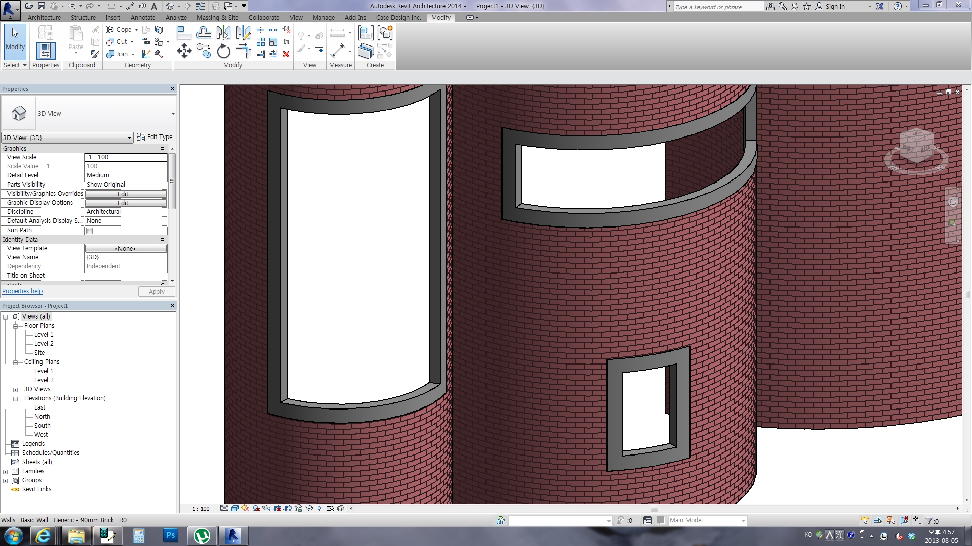

When curved frames or windows like attached image are nessesary, it's a little bit tricky to make.
i used some trigonometrical functions with adaptive component.
this video is the one i recoreded when i studied about  trigonometrical functions for revit about a year ago, and i used this for the frame family.
http://youtu.be/Nl6823dEe4Y
And this is a video i recored the frame family i made.
http://youtu.be/iADhgdPjhr4
The family is attached at the video.
Hope this helps somebody..:-)
