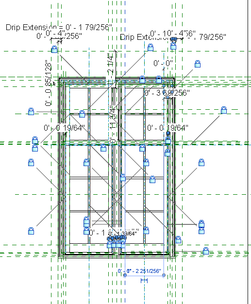

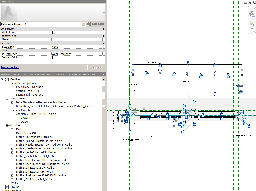

I modified the Kolbe for my last muttion windowed project but it was a pain!  Way too complex.  I blew away all of the embedded details (hate those).  Then I deleted unwanted types and then tried to simplify ... but this window is very - very complicated.  Way too may reference planes and adjustments.

Agreed:  Kolbe families take 30-60 seconds to duplicate and modify (as opposed to nearly instant for simple windows), then the same amount of time to insert:  smoke comes out of the CPU.  All I really want is muntons added to the basic families.   I definitely don't feel like building these myself.    Happy to pay the smart people to build them for me.
