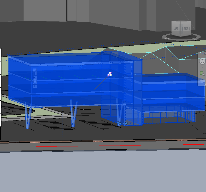

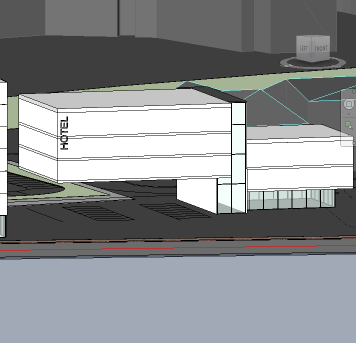

Yesterday we have set up a workset at work to share the project that have been going on for a while. And today I have discovered that some elements, that are a part of a group, are not showing on any views, not plans not 3d. But it you select the group then you can see that they are there. How to fix it? and what have caused it?
 We have checked with my colleague if maybe its a workset fault, tried to sync couple of times. but he sees the same problem.
See attachment.

I have several buildings in this project and all are in a very conceptual phase. So I grouped this one in order to make it easier and faster for me to move the whole thing around, while the urban planning is going on.
The problem is the columns that have dissapeared from the group. When you select the group you can see them(as is showen on one of the pictures), otherwise they are not there. When I open a group to edit it, then they are not there either.

Ah-ha .... columns ... And you initially had grids - correct?  Columns associate with grids and when you move the building....no grids to place the column.
This is a poor use of groups.  You are better off to have everything on from a plan view set above everything with an infinite depth ... and with grids on.  Then window the area and move everthing.

Grids! Of course!! Its been a looong day!
Thank you Winking
