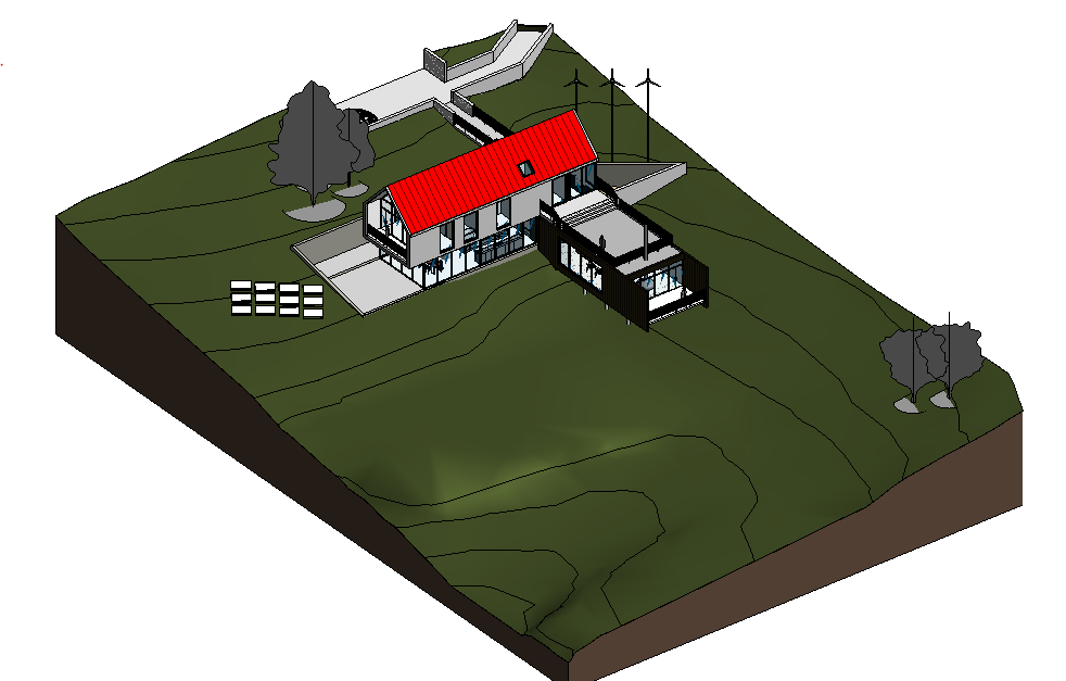

If your Revit topo is "incorrect" then your input was incorrect.  I can't stress enough that the system works and using other modeling sources is a poor solution.
Your best Revit topography is created directly from the points file created by the surveyor.  ..... And every point will be exact!  Then any grading you do can be quantified correctly right out of the model.
Revit's contour lines can show in the 3D model as shown attached.

I know the contours show in the 3D view, bit I'm asking if there's a way to make them show on other objects (masses) besides toposurface.
Let's say I manage to guess some extra points and end up with a decent toposurface, is there a way to use it to 'cut' a mass? (I only need a rought estimation on the volume. Using a pencil and calculator for production is ridiculous nowadays.)
