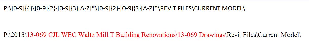

What am i missing? I cant seem to get the PROJECT SAVED LOCATION to work correctly. See Image attached

I'm stuck on exactly the same issue.  Did you resolve this?

I think I can help.
P:.[0-9]{4}.[0-9]{2}-[0-9]{3}.*.[0-9]{2}-[0-9]{3}.*.Revit Files.Current Model.+
