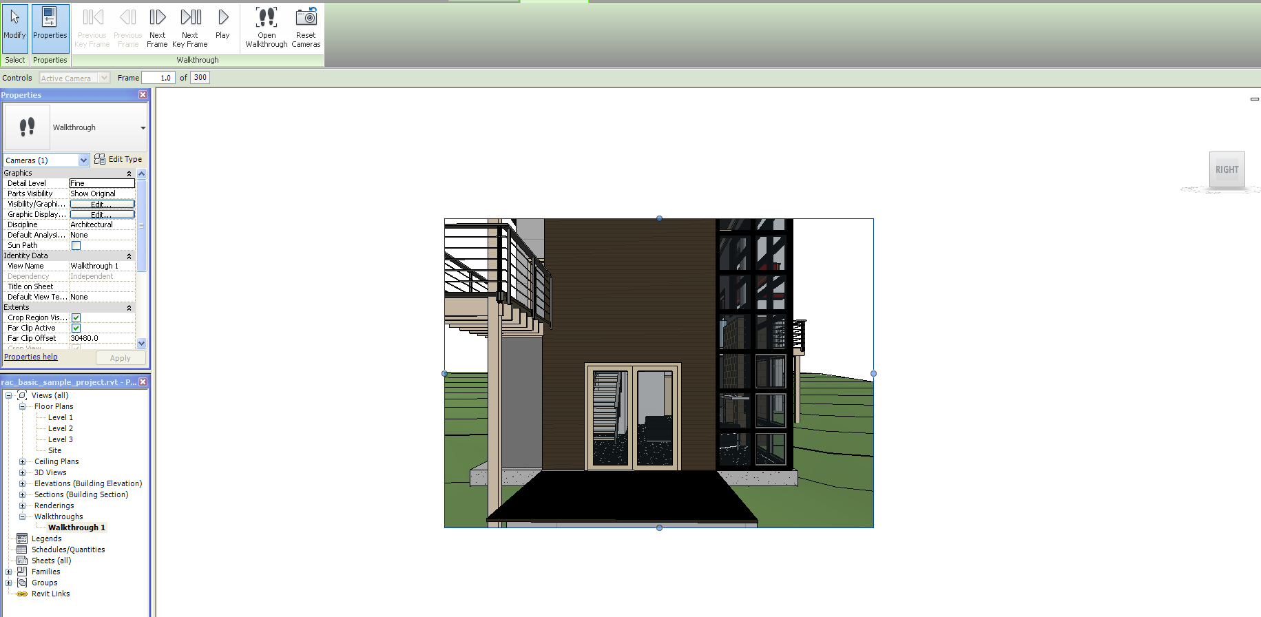

I just installed Revit 2013.  I created a walkthrough path on the sample building and I can't find the playback or editing controls.  The WikiHelp is useless.

tazman1- Wikihelp is not useless.see this link http://wikihelp.autodesk.com/Revit/enu/2013/Help/00001-Revit_He0/1468-Document1468/2164-Walkthro2164/2167-Editing_2167
let me know if it's helps.

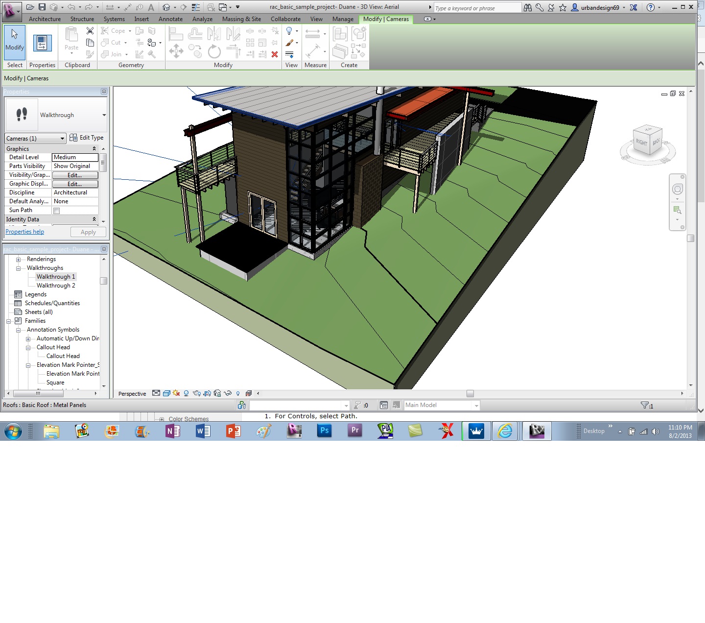

I read this before.   Am I overlookng thewalkthrough panel? See Attached.

Step:1
First create a walkthrough and finish it off.
Step :2
In Project browser, you can see Walkthrough.double click and you get the walkthru window.
Step:3
Click tht window.you can see top  Edit walk through click that.. you can get key frames in Left Corner.
Step : 4
Click tht upto your start point. your play button is turn on... press the play button then animation is running...
Enjoy...
