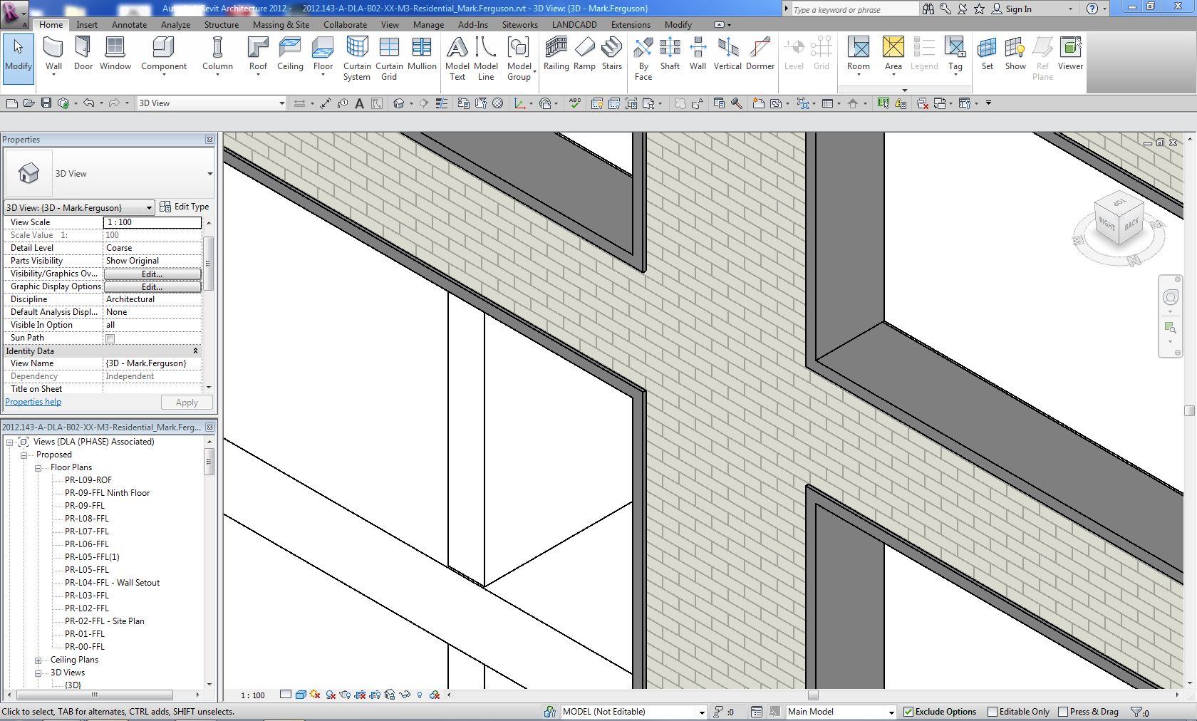

I have created a window family that I use to cut regular voids out of walls in my project.  I have added a frame to create reveals and this works really well for what I need it for.  However the building also has curved walls and I need to create a family that does the same thing but on the curved areas.  So I need to be able to enter the arc length and then for the family to create a frame around the newly created void.
Thanks for an help or advise on how to do this.

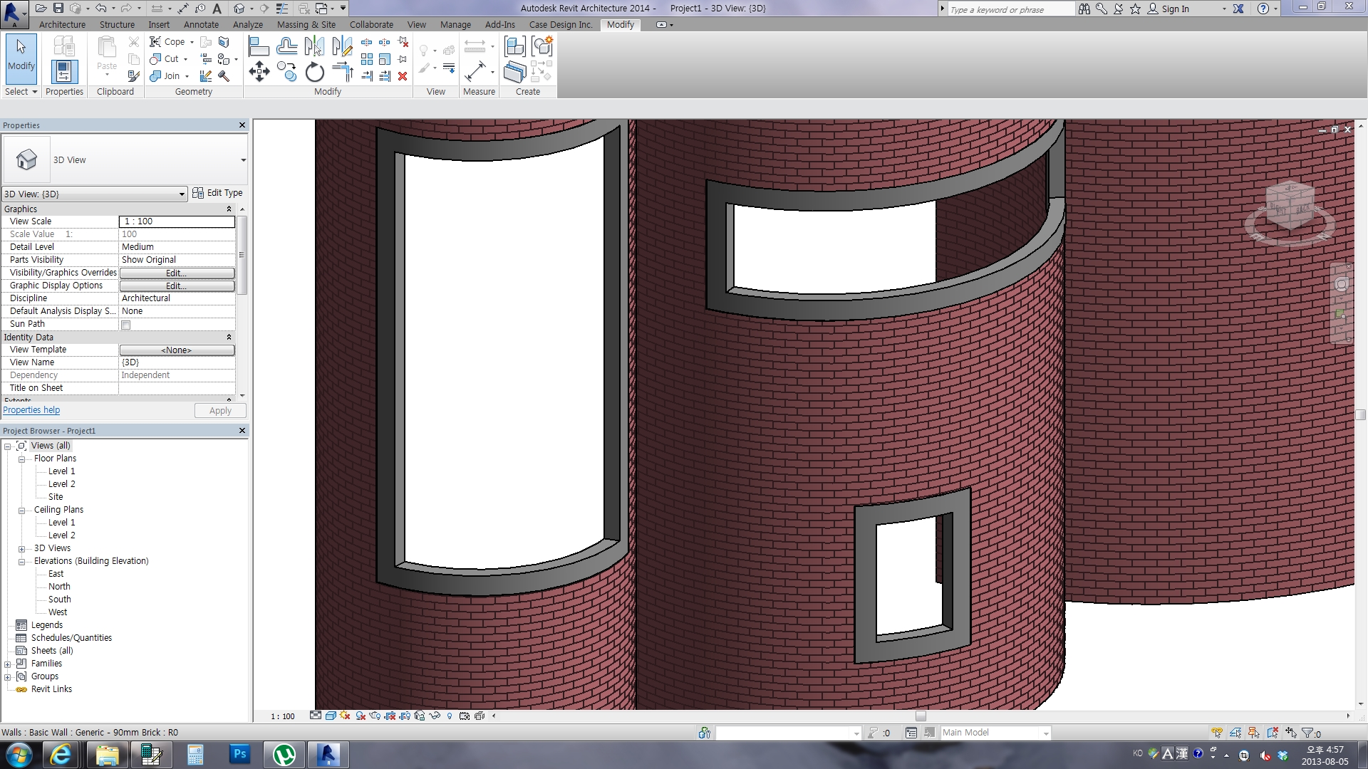

this is a little tricky mission..
but this can be achieved by adaptive component.
you can make this kind of family with adaptive component & formulas.
watch this video, and i also attached a download link at the video
http://youtu.be/iADhgdPjhr4
and this is my reference to make 3-Ponits Circle
http://youtu.be/Nl6823dEe4Y
