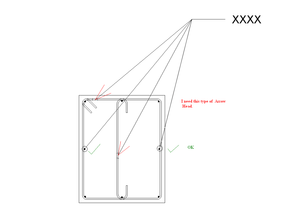

Hi,
I hope you can clarfiy this issue. How can i change the different Leader Arrow Head ? please see the attachment.
sorry for asking this simple Question,becaz i am new in rebar detailing.

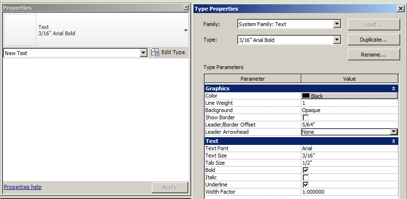

Click on your text and in your properties edit the type and change the leader to whatever you need.  You may need to duplicate your text type.

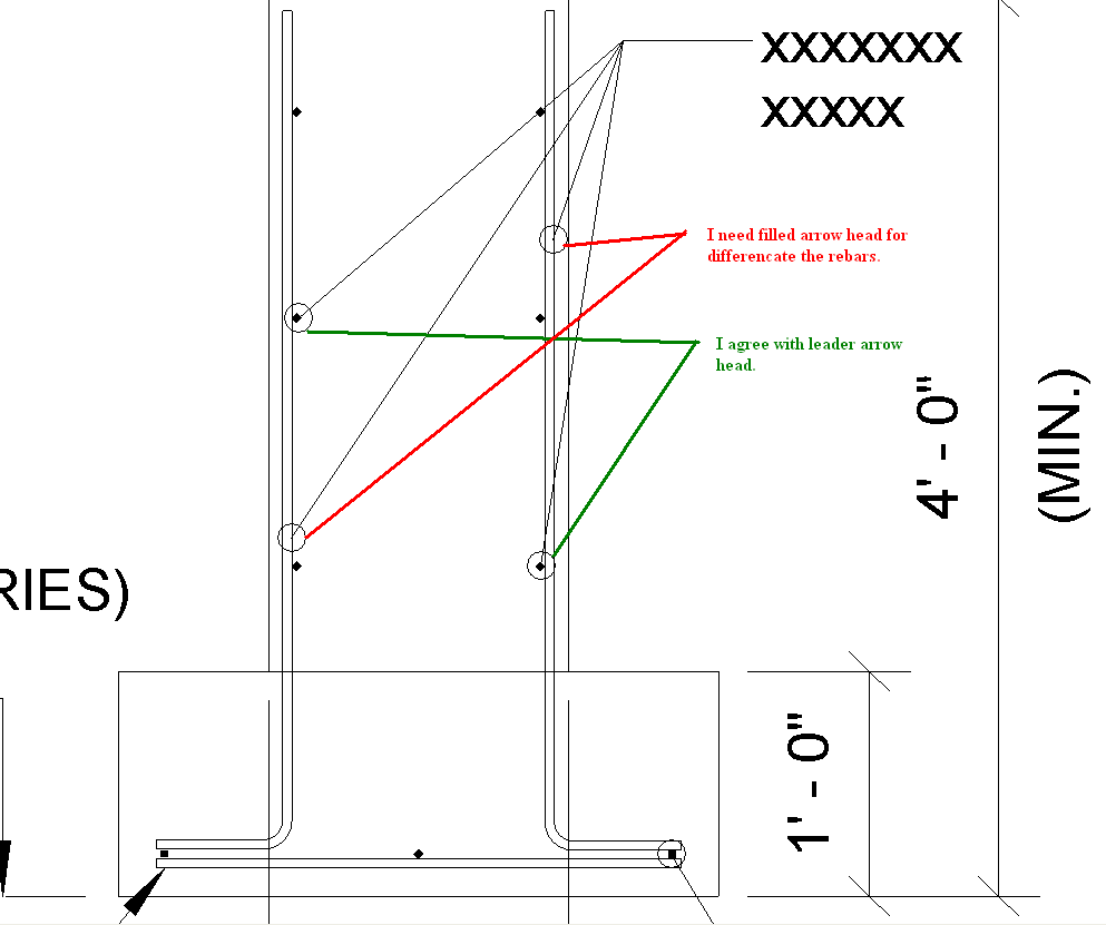

I think you don't understand my issue,please see the attachement for your better understanding.

I think you did not ask your question clearly.
You can not have two different arrow heads from the same annotation but you can have different annotations with different arrowhead types.

Sorry for the clarity my question. but, how can i have the different annotation and different arrowhead types? please share me the specific ideas.
Mon, Jul 29, 2013 at 9:08:07 AM | How can i change the Leader Arrow Head
caddeva - Teafoe already answered that question.  Create a text type with the arrow head you want - the arrow pulldown shows you what you already have defined in your project.  You define arrowheads under the manage/additional settings.
