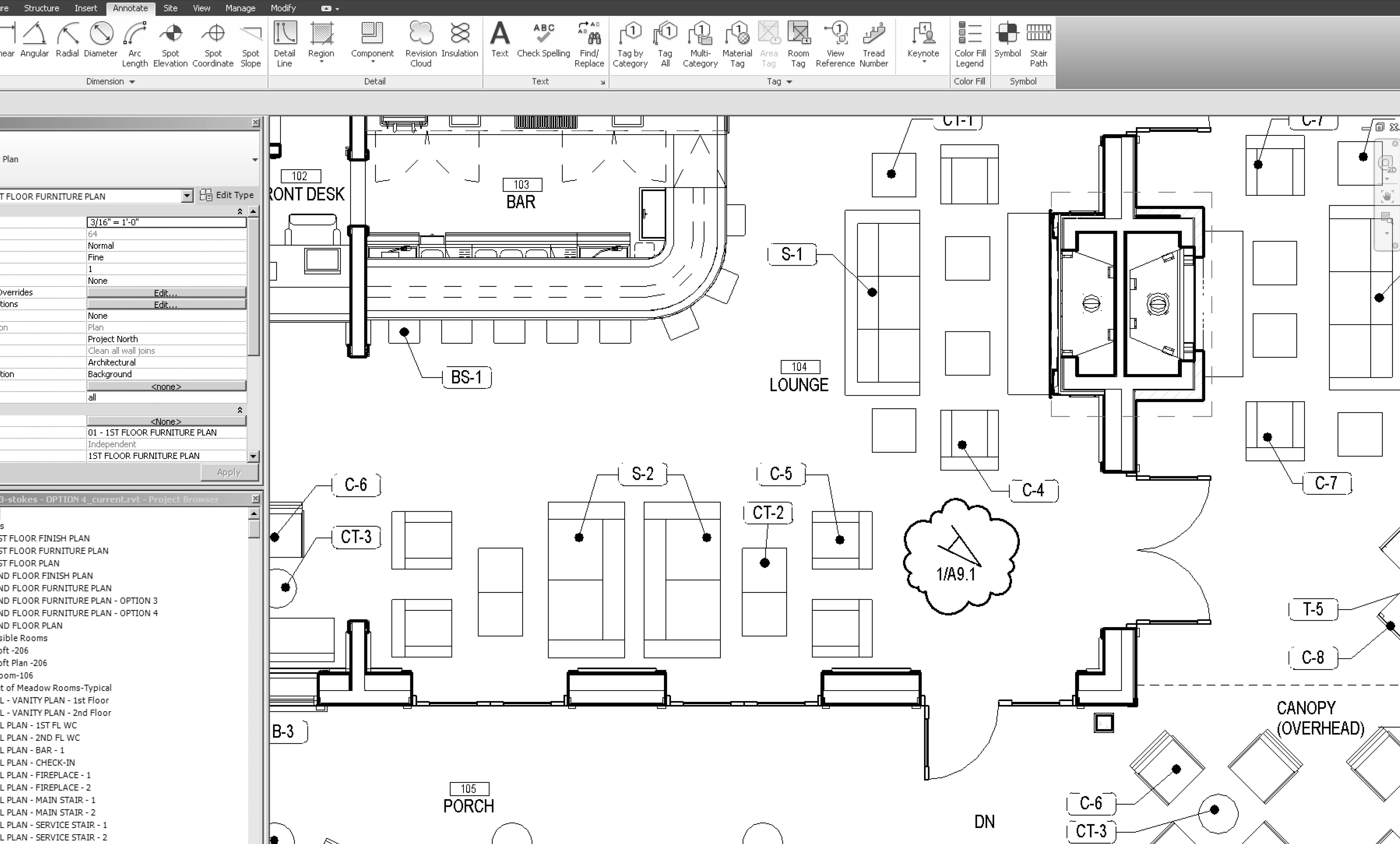

I oftentimes wish that I could tag a 3D perspective in plan, much the same way that we tag sections and elevations.  I often use a 3d view to describe something, and if there was the possibility to create a specific tag for this type of view and place it in the plan, it would be great.  For the time being i'm just placing lines in a cone shape on the plan, with the drawing number in simple text.  Anyone else share this wish?

Creating the empty drafting view is interesting idea.  Basically i was using text to refer to the 3D view as a workaround.  See the attched view.   I suppose its not the most common thing to reference a 3D view in plan, but it would be nice for instance to set up a key plan with 3D views tagged in plan and have a sheet of 3D views.  I mean, why not?!?
