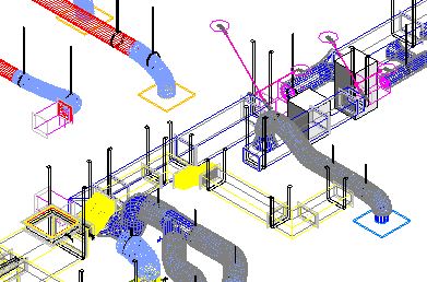

i can view the CAD files fine in autocad 2013, but when i link or import these CAD models their ducts/pipes do not show up in my Revit model (the bracing and other generic items from the CAD do appear)

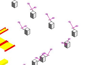

the weird thing about this, is that a few weeks ago i could see everything fine when i linked these files but since i have tried to reload because of changes to the CAD model the ducts/pipes no longer appear (so as long as i dont reload the file the original still appears fine, but as soon as i reload the ducts/pipes dissappear). i asked the person who made the CAD files if they changed any formatting but they havent. so im guessing that i have changed something in my revit program. i have turned on every visibiltiy option and changed other view settings to see if it has any affect but nothing. like i said, i honestly believe that it was a system change either with my revit or computer. btw i have found a long fix: explode the model and do a polymesh conversion something, it works but takes forever with the file sizes that im working with.

i've tried the family fix. i open up a Generic Model and when i insert the CAD file (to try to save it as a family) the same thing happens and the duct/pipe do not show up.
(if my attachment worked...the 2 pictures shows how it would look when the duct/pipe used to show fine and how it looks now whenever i try to reload or just link)

everything in cad is there like it should be. in the pictures that i uploaded a few posts back, in the 2nd pic where the duct/pipe no longer show you can see that they have been replaced with generic boxes. (these cad files come from a client and this only happens some of the files and they have said they havent changed any formatting)

I had the same thng happen and I had to change the "PROXYGRAPHICS" to 1 instead of 0
and work fine
