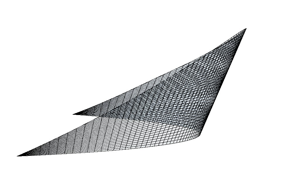

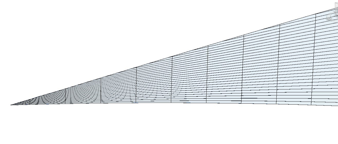

I have a double curved mass in revit (imported from rhino) that I have applied a curtain system to.  But the system can’t keep orthogonal division, because of the form is curved in plan and in elevation. Is it possible adjust the curtain system grid which applied to the face can run 90 degrees vertically and horizontally.

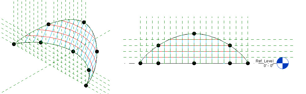

It can be done by dividing the surface by intersection. By the way, the form can be created in Revit. Please refer to Wikihelp for details about the method of intersection.
