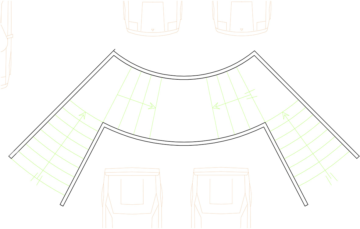

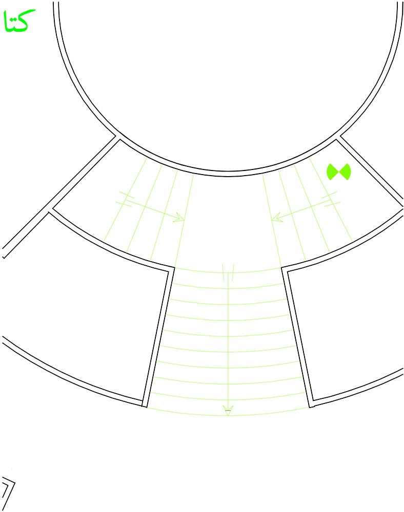

i am trying to create a stair case that starts as 2 seperate runs i don't know how to get that into revit do i know how to make revit do the stair i want. i have created half of the stair in revit but if i mirror the run of stairs it thinks its a new flight and goes in the wrong direction. ...that's not an issue. but if anyone can help with the stair that'd be great. thanks

watch this
http://youtu.be/cJXkmJEJuqA
