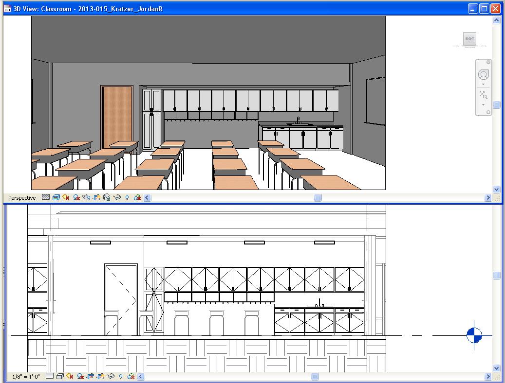

I am having trouble with the lights showing up in a 3D view. First, they don't show up. Second, the rendering is black despite there being a large window behind the camera and 12 ceiling fixtures. The lights are not recessed. The rendering recognizes that there is a light source and they are the ones I have placed, but despite the settings all I get is a black screen for a rendering. I have rendered before and this has never occured. Is there a setting I am missing. I am used to Revit 2013, and am using 2012.

Are the lights on in the redering setup?
You probably have something (a solid) right in front of the camera.
I don't see any lights on that ceiling in your 3D view.

I didn't see it so I thought it didn't post so I reposted, my bad. Thanks for deleting it. I figured it out. The ceiling was blocking the lights because of the Design Options and the change in phase. I had to get the right setting set up for it to show up. Thanks.
