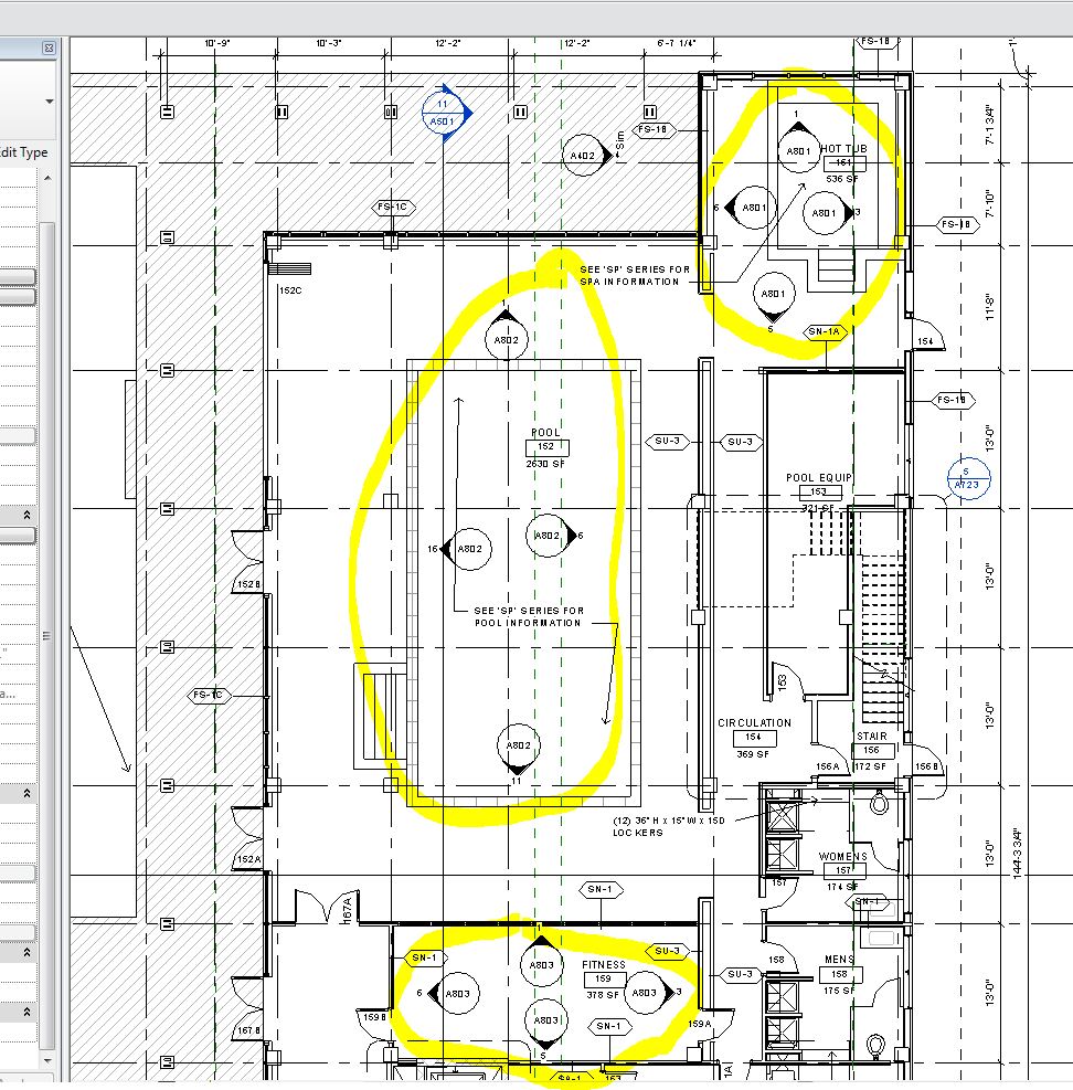

I have a project going with and had a person new to revit create the interior elevations in the model. But before I could catch/correct the problem we had 4 interior elevation callouts, each with their own sheet callout bubble. Is there anyway to convert individual elevations to tie into one elevation sheet callout bubble? The elevations have already been cleaned up and noted, so remaking each elevation would be very time consuming. Any suggestions would be greatly appreciated.
You can see the attached image to see the added clutter the multiple bubbles add to the plans.
Thanks

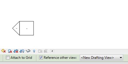

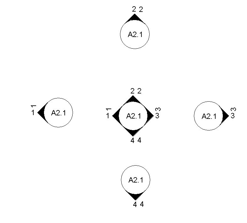

You can create an elevation tag that references one of the existing elevation views and place it where you want it. Be sure to check the reference other view box and select the view you want to reference before placing it. Once it's placed, select the tag and a check box for the other 3 directions should appear. Click one box and it will ask you which view you want that particular direction to reference. Do the same for the remaining two boxes and you should have one tag pointing 4 directions with the approriate elevation callouts. Then all you need to do is hide your original elevation tags. Hope this makes sense. You'll have to edit type the referring tag to remove the 'Sim' text as well.

Can't seem to get two images to post so here's the second one.
