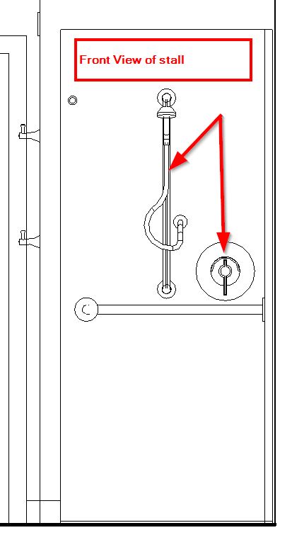

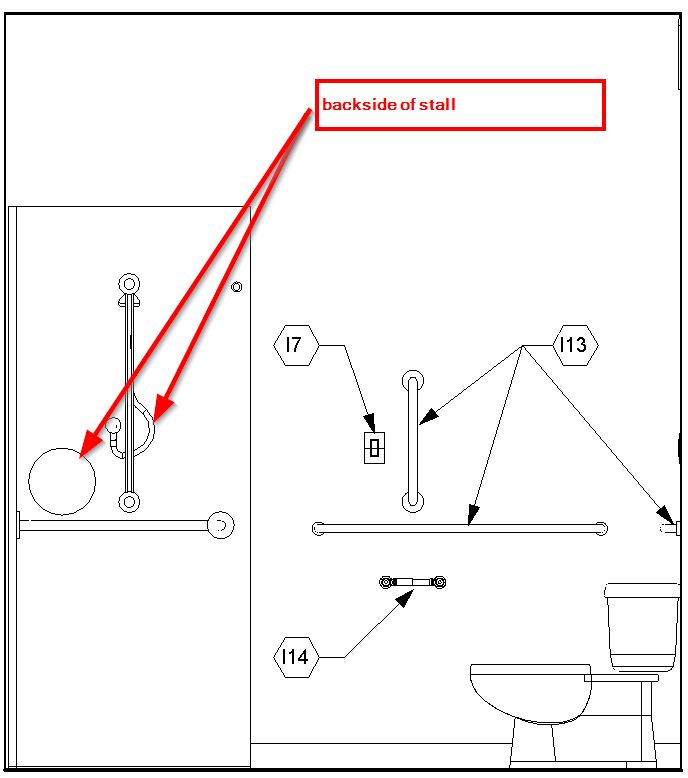

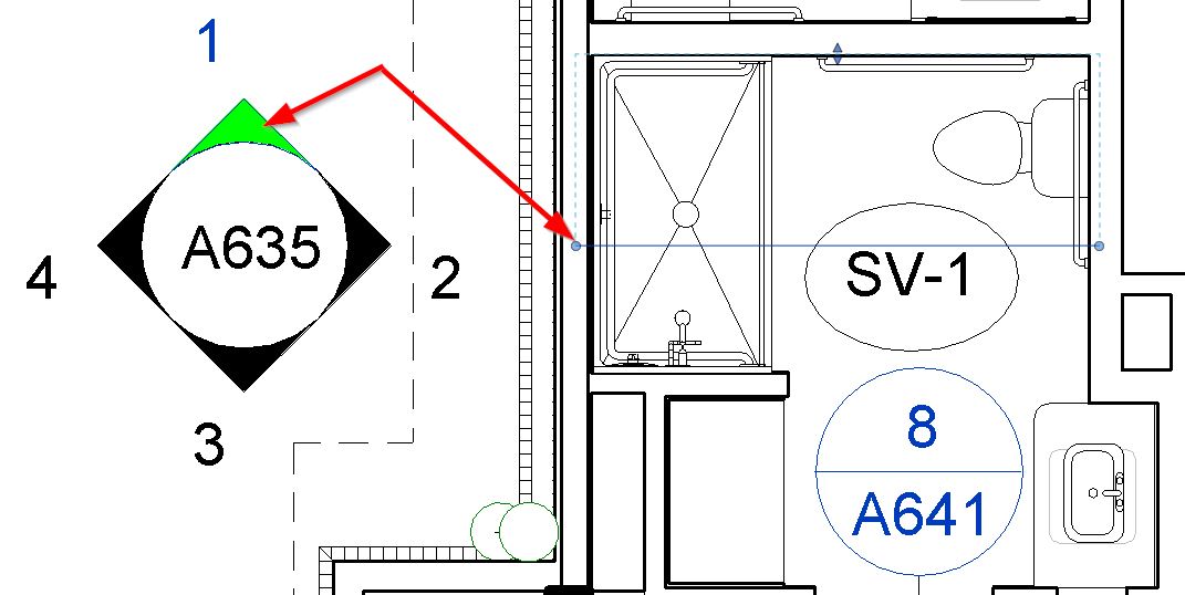

this is a new one for me, and i consider myself a pro, but for the life of me, cannot figure this one out. Revit 2013: it would seem that i have an interior elevation for a restroom. (See image "Plan View" and notice shower arangement and where cut plane is located) now when i go to the opposite elevation it shows the backside of the elevation i was first referencing. (See image Back Elevation) this is driving me crazy!!! (See also Front Elevation for reference).

Your problem is this is an all in one family - correct?  Because the category is not cuttable, all elements show up including what is behind the cut plane.

Open the nested families in the family editor.  Under the Create tab click the Family Categories and Parameters button.  Under family parameters scroll down and check the 'Shared' box.  Load the familes back into the project.
The 'Shared' parameter is only relevant when the family is nested. If shared, you can select, tag, and schedule the nested family separately from the host family.  It also allows for the nested family to not always display when the cut plane of the view intersects the host family.
