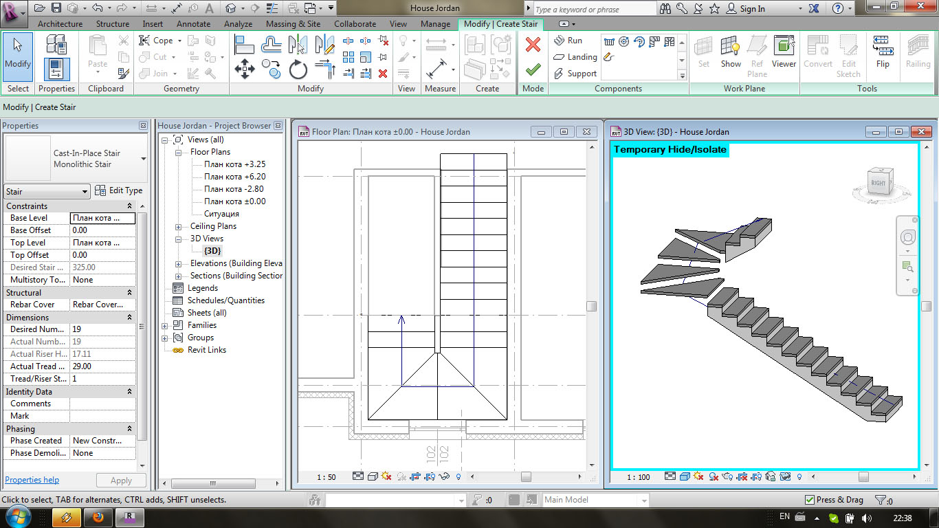

Hello everybody Smile
So I am trying to make these monolitig U-shaped stairs...
I am creating them by sketch, because the U-shaped winder component doesen't give much freedom.
My problem is that the angled risers keep disappearig.
What might be the problem here?

here's what you want.
whatch this.
http://youtu.be/79m1S_KSxpc

Thank you! That worked for me.
