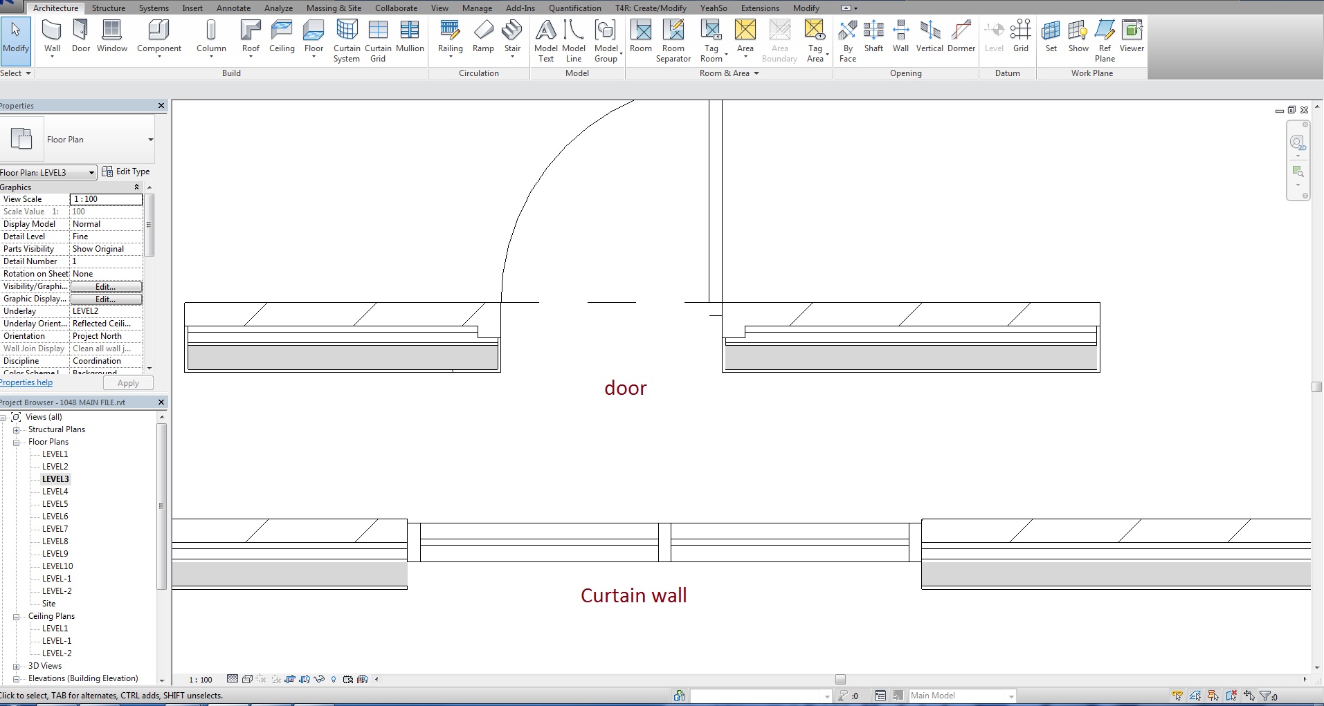

Hey guys,
Does anyone know how to make wall layers wrap around curtain walls the way they do with doors and windows??
Thanks.
Mon, Jul 1, 2013 at 7:33:44 AM | Layer wrap around curtain wall
You will have to place a seperate opening to achieve that and put your CW in that opening.
