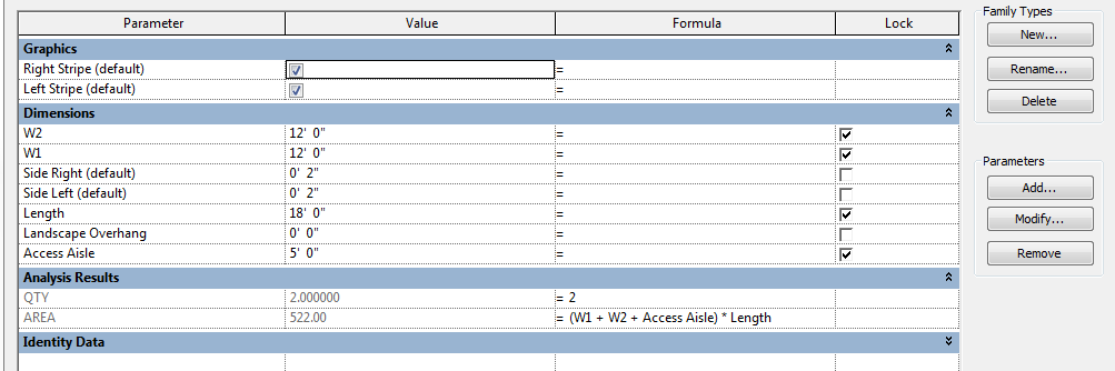

I need some help her if it is possible....I tried to insert a Conditional statement without luck..
What I need is if I check a YES/NO value (Right Stripe) another avlue ( Side Right) change  the value from 2" to 0". Attached is the properties window so you have a better idea....
Thanks 4ABs
Thu, Jun 27, 2013 at 8:51:32 AM | Conditional statement
If (Right_Stripe, 0",2")

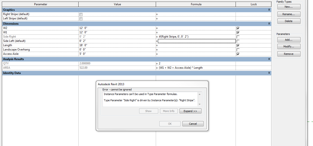

But now I have a little problem ..I have an ERROR -CANNOT BE IGNORE.....Attached is the window error , please take a look and let me know.
THANKS,
4ABs
Thu, Jun 27, 2013 at 9:22:10 AM | Conditional statement
That error is self explaining......
Change your instance parameters from instance to type or the other ones from type to instance.
