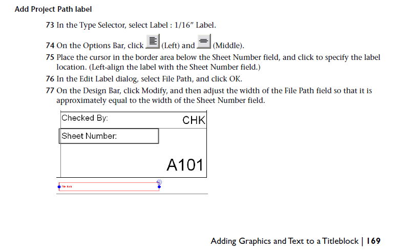

1 thing more.  is it possible to add filename on a titleblock family, so that whatever filename I make for my project, where the titleblock is also loaded,  the filename field on my titleblock automatically appears.  Just like the filename field in Autocad.  We incorporate filename in our titleblock to serve as our reference file.

Fri, Jun 28, 2013 at 8:00:06 AM | Multi-line labels on titleblocks
I keep writing that users should download and READ the "Families Guide" from the autodesk website.  See the clip below

thanks for the reply whub,but i was asking for filename to be placed on my title block,not d file path.am i missing some inputs here?

Hi Bigbrother,
Try followings:
1. Go to sheet view A101 for example. Right click your title block, then click "Edit Family". This will bring up that family.
2. In "Create" tag, in "Text", click "Label", then click the spot where you want to place your lable, "Edit Label" window will pop-up.
3. In left panel select "Date/Time Stamp" move it to right panel, click OK.
4. Create another label, this time select "File Path", which has file path and file name.
5. Reload your title block into your project.
That's it. (Revit 2013)
