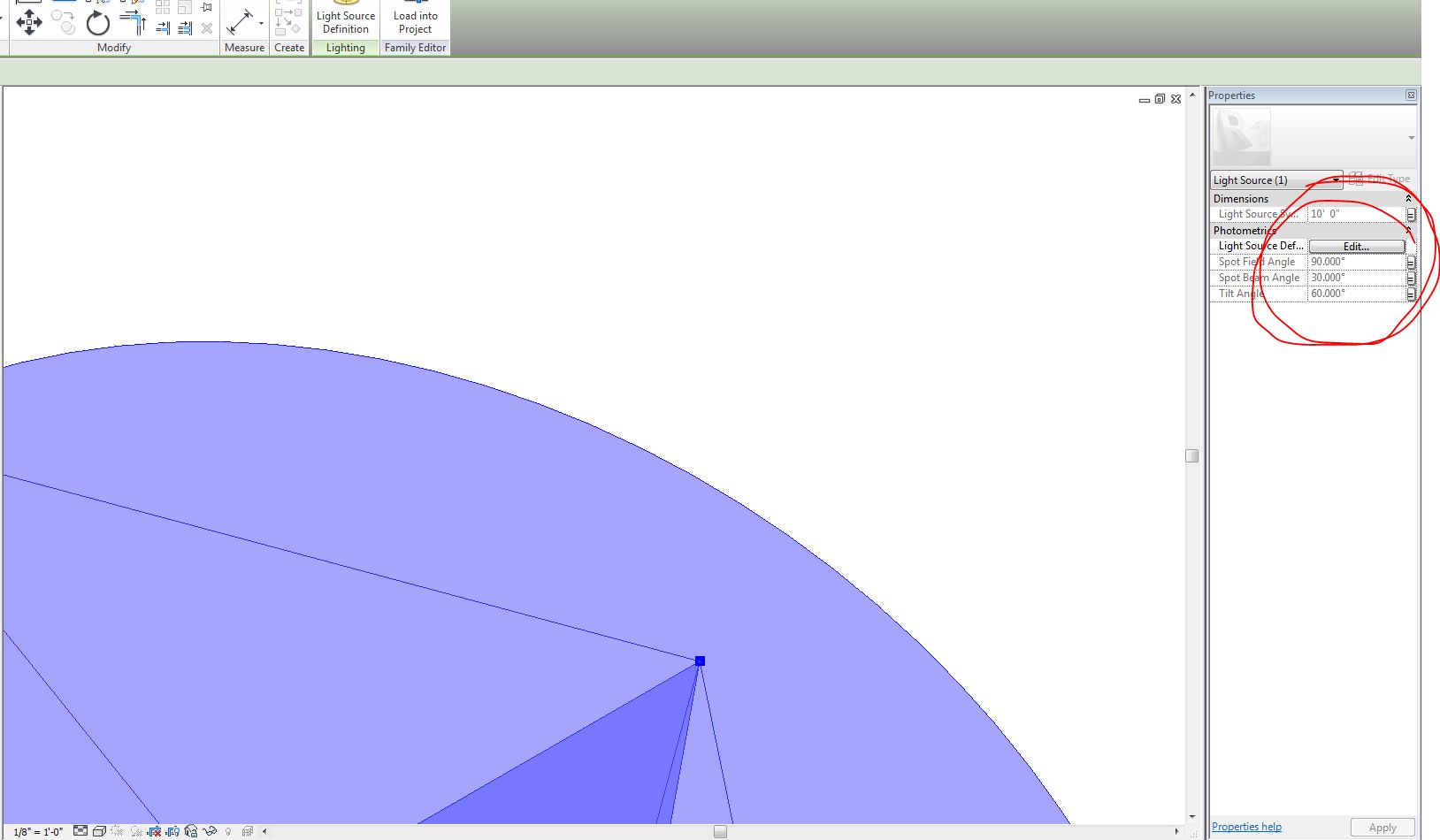

3 things:
1) Try recreating the IES based system and remake the Revit file, import it in, and align it from there.
2) Create a reference plane (work plane) for it to attach to.  attach and rotate as required.
3) There should be a tilt/angle control.  I think by default its set to some pretty odd angles (see attachment)
