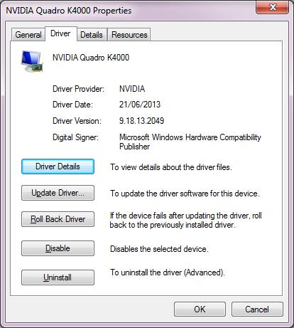

Hi RB Cameron,
We have just received a K4000 card and we are starting to see issues when pushing the boundaries of files around 450Mb.
The issues we are facing is that we are seeing multiple displays of objects when zooming in and out. It appears like it isn't clearing the regeneration of objects as it increases and decreases their size. Mainly we are experiencing that with dimensions and text but it is also effecting modelled components like walls etc.
Can I please ask you what driver you have installed as this seems to be the cause of this kind of thing normally.

JPanda
I try to stay on top of whatever the latest driver nvidia offers.  in this case its the 320.x now.  For Revit 2013.
http://www.nvidia.com/object/quadro-tesla-grid-win8-win7-winvista-64bit-320.49-whql-driver.html
As a side note, I typically don't run over 400Mb on my files, so do whatever you can to take that unwanted file size down.  There are a few good tips on file size just by googling or searching AUGI.com.  I have a good idea what you're talking about though, and if your 3D view is doing something goofy, I suggest deleting it and creating a whole new 3D view from scratch, not duplication.  That solved one co-worker's issue immediately.  Also, this occurs in plan views too.  Toggle the "use hardware acceleration" checkbox in options, as well as anti-aliasing.  I also changed my background colors to Blue, Blue and Orange with semi-transparency turned on.  Basically Windows is fighting Revit for control of who's in front of the screen.  We had a similar (maybe the same?) issue when windows rolled out an update about 3 or 4 months ago.
Also, CAD tends to do weird things to Revit 2011, 12, 13 and not sure about 2014 yet.  Not sure about what version of Revit you have or the other potential conflicts you have in your model though.  Have you been crashing or is it more of an annoyance sort of thing?
EDIT: Is it doing something like this?  see attached
