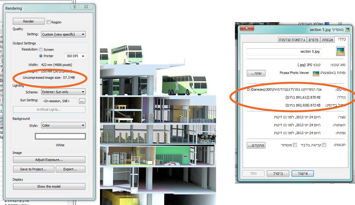

hello everyone
Beforehand revit says the uncompressed file will be 57.3MB and when the render complete the file size is less then 1 MB!
but i need it to be printed on over a one meter page! so it better be NOT compressed no?
how should i tell Revit NOT to compress the file?
thank you

I would suggest that you save as tiff or bmp and if you need compression use photoshop.
