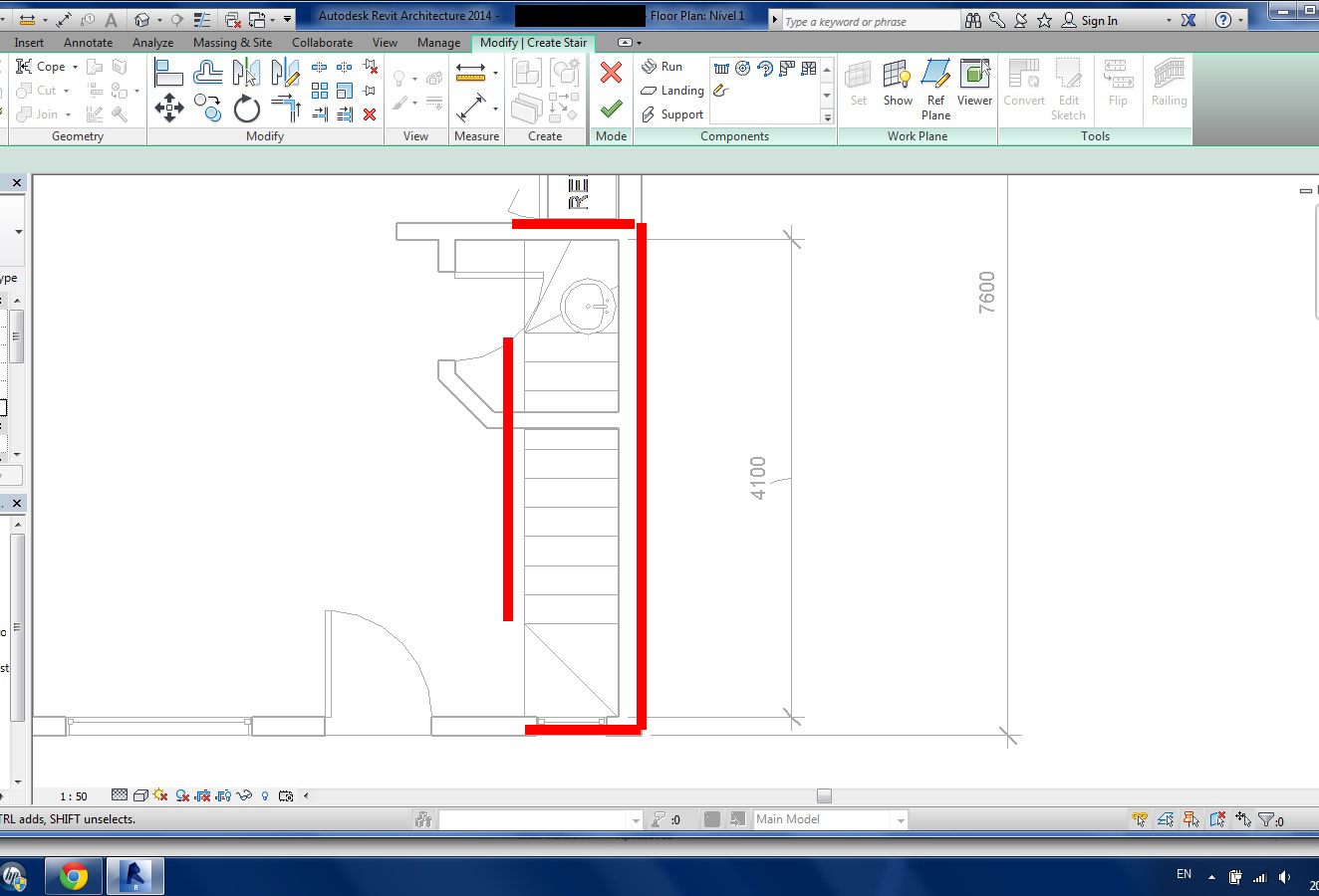

It's supposed to be something simple but I cannot figure it out why it's not working. I sketched out the stairs format with model lines to use as a guide and so you people can have an idea of what I want to do. I've also highlighted in red and to the sides the lines that I used as boundary lines.

try breaking your stringer lines up at junctions of winders and straight run, ie where the landings would be if you didnt have winders on the turn.

i've tried doing it but it wont give me all the steps that i need on the winders. it will only give me the first and the last.
