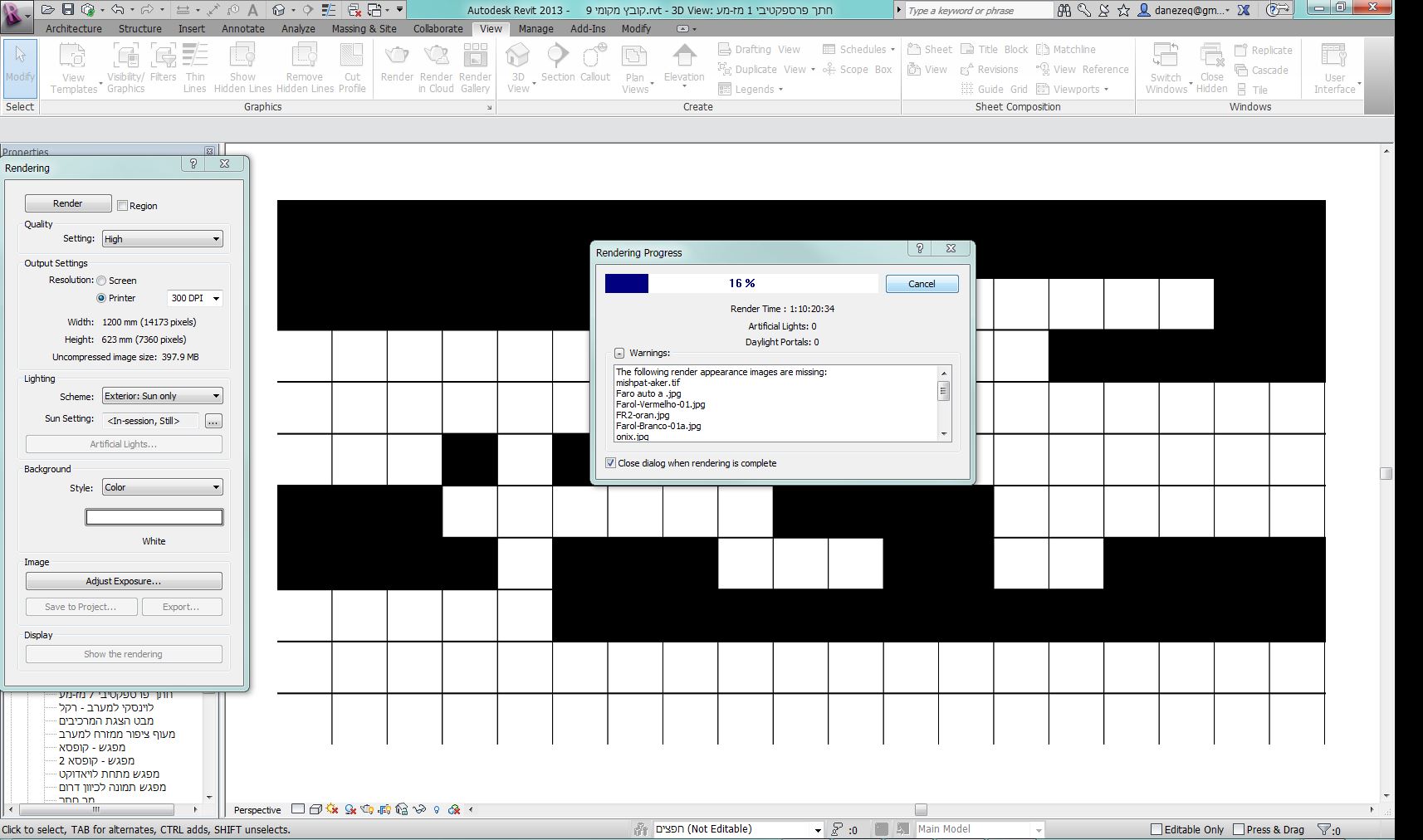

Do you think it's reasonable to continue redering in my computer? look at the time.
that's a really big image.
the computer is quite strong:
18G RAM (1333MHZ)
motherboad: Gigabyte x58a-ud3r
cpu: i7 950

Look at the size this rendering will be.  Do you really want these settings?
Obviously, you have some elements in here that are too finely detailed.  Is that a really intense pattern that ends up rendering black?  Maybe you have some model elements you need to change.

Yes, this is going to be a poster in size of 1200X600mm
and it is very detailed indeed.
1. i turned off irrelevent worksets.
2. i putted only the relevant part inside a section box
i need all the rest.
maybe i have some other mistakes?
