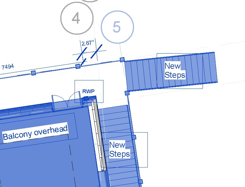

Strange problem, I have two walls in my project which have become un-selectable. In the attached screenshot it shows one of the walls not highlighted. This was despite doing a drag and select over the area. Also strange is that I cannot select either of the grid lines that these two walls are on. From searching about the solutions seem to be to check if the walls are in other design options, which they are not. I can't select these walls in any views by dragging selecting, tabbing though objects etc.
Using Revit 2014
Any ideas on what's happened?

OK solved this seconds after posting ha! Walls had been pinned but the 'Select Pinned Objects' tool had been disabled!
