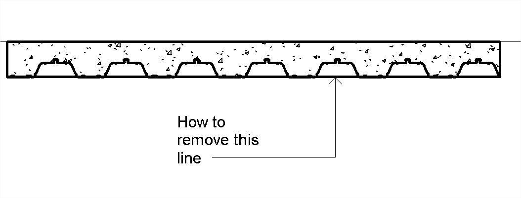

I have just made a new metal deck profile and loaded it into my project, I created a new floor type with my new metal deck profile loaded into it and when i come to model the floor i get this line at the bottom (see attachment)
this doesnt show up on all my other floors, Can this be removed ?

Do you have mroe than one floor in the same place?

no i made a new floor type with the new metal deck profile in it and i get a line at the bottom of the floor. on other floors i dont see the line.
Is it something to do with the profile ?

"on other floors i dont see the line"  Are you saying these lines have a different metal deck profile?  If so then I would assume it is a problem with the profile you created.

Hi,
Not sure if you got your answer already.
Set far clipping setting to Clip without line.
