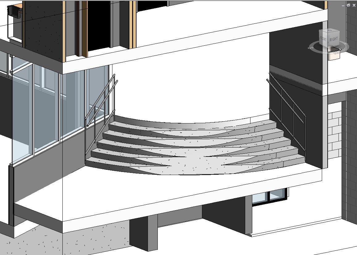

I am trying to create a poured concrete entry staircase in Revit 2013 with radial treads. Unfortunately, Revit doesn't like this and cuts chunks out of the stairs themselves. I never ran into a problem like this with 2012, but a lot of things have changes in the 2013 stair tools and am having trouble working around it. Anyone have any thoughts or ran into similar problems. I have attached a JPEG to illustrate what I am describing.

Put a value in "Tread Thickness"

Works perfectly. Thanks a lot!
