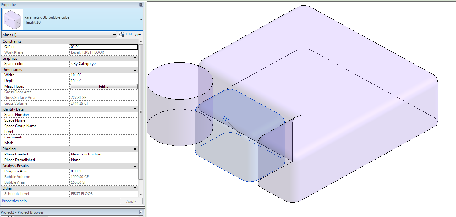

I am trying to assemble a program for a client. I want to use the massing aspect of Revit. I have bathrooms, meeting rooms, offices, cafeteria, etc. as rooms with particular square footages for each on a spreadsheet. I want to somehow import the spreadsheet to assemble the specific rooms with their proper square footages where I then can manually manipulate them to conform to the programming requirements. How do you do this? Moreover how does one label / color these spaces so one can see what spaces one is manipulating?
Wed, Jun 19, 2013 at 4:19:55 PM | Programming spaces/rooms in Revit
You should already know that you can't import a spreadsheet.  That being said, nothing can be automatic.  You can create individual masses with each one defined by length/width parameters that you set to "match" your spreadsheet.
For our office, I created some 3D bubble families that were scheduable to do bubble diagrams.

These are parametric mass families and as you can see by the properties, they can be named and scheduled.  It also has a field for the programed area so the schedule can show actual vs program.
To transition to plans with walls - we simply place walls by center by pointing to the edges.

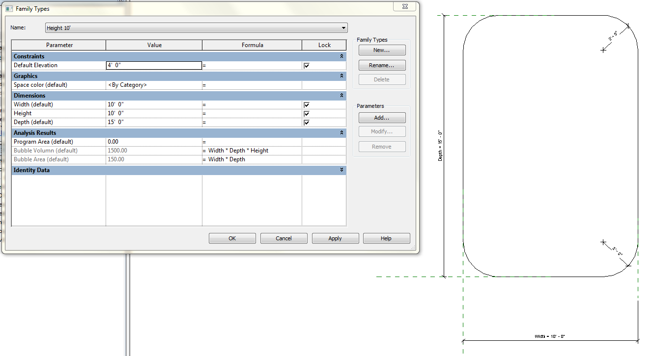

I need guidance on how to set the parameters of the MASS in the family editor. Do you have a step by step instructions on how to apply he proper parameters?
Thanks!
Fri, Jun 21, 2013 at 8:00:14 AM | Programming spaces/rooms in Revit
There is nothing special here - see attached.  If you want any of these parameters to schedule or tag, you have to create them as shared parameters.
I suggest you download the "Families guide" from the autodesk website to lear all about how to create and modify families.

Thanks WWHub. I have downloaded it and will begin, seems easy enough. My last questions is how do you label them as you place each room/area in the program so youy cna keep track of whats what?
Thanks!
Fri, Jun 21, 2013 at 9:20:34 AM | Programming spaces/rooms in Revit
#10
You have to create a multi-category tag that uses the shared parameters you put in the family.
