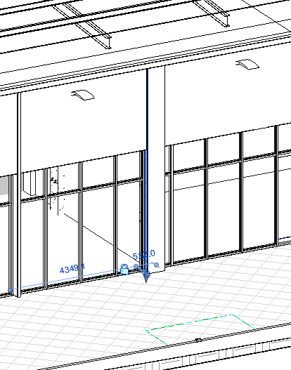

Hi All,
I am using the Wall tool to create a cladding for a structural column. The cladding runs all the way up to the underside of the roof and intersects another wall I have used to create an over head bulkhead. I have aligned the cladding with the shop front, however - it will not show this in plan it stops about 125mm away from it even though I have aligned and dragged it to the shop front multiple times. I think it is because of the intersection higher up but I am not 100% sure. I thought having a standard view range would counter this but it seems to keep cutting the wall where it theoretically intersects with the wall above.
Can anyone confirm this, and if so does anyone know a way around it - to get the wall to display in the plan view butting to the shop front.
Tue, Jun 18, 2013 at 8:42:54 AM | Extent of Wall not showing in Plan: Intersecting wall above
Either split these walls horizontally where they need to join / end at different points, or set the wall to that height and then copy paste all of these walls to the same place but with a different height offset and different top height.
