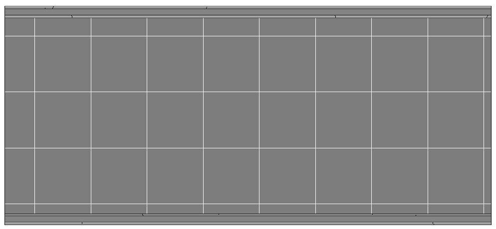

I have been trying to select a line in my floor pattern in the way both yourself and F1 HELP suggests, but this does not seem to work on the crosshatch pattern I have applied to my floor material or any other pattern, (see attached jpeg and revit model).
I have tried by painting a surface with a pattern and also setting up a material with a surface pattern and then creating it as a floor, it does not work either way. Pressing tab does not select anything other than the entire element, there are no shape handles to select at all.

Right, done a bit more investigating. The problem is that my floor displays a drafting pattern. I need it to display a model pattern in order to edit/align it. So the question is...how can I create a floor which displays a model pattern?
I am using Revit Arch 2013, and two books, Autodesk Revit Arch 2013 N.E.R and Autodesk Revit Arch 2013 Essentials and neither offers an explanation.
