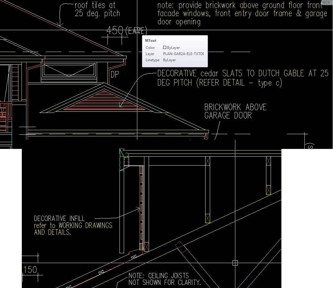

hi, anyone know what is the best way to create this look in revit is? a larger slat runs around the outside perimeter of the infill. Is there a way to make the wall so it can be adjusted and stretched without needing to move individual battens?
so ideally, a wall or object, that has an individual batten profile for the  boarder perimeter and an additional profile for the horizontal battens that are spaced equally inside the triangle.
Any ideas would be great

You could use an inplace component extrusion for this

as in extrude every piece of timber individually? any tutorials any one is aware of? or someone that has done this before and is will to share that part of their drawings.

You can do multiple extrusions in one in-place component.. i would not do this.. i would use a material or paint fir the elevation and use a detail component for the section.

have you seen any any tutorials on this? im new to this and not too sure the steps... thanks once again

Tutorials on create a family?  Look at this http://usa.autodesk.com/adsk/servlet/index?siteID=123112&id=14996975  Its from 2011 but it still applies through this release.
