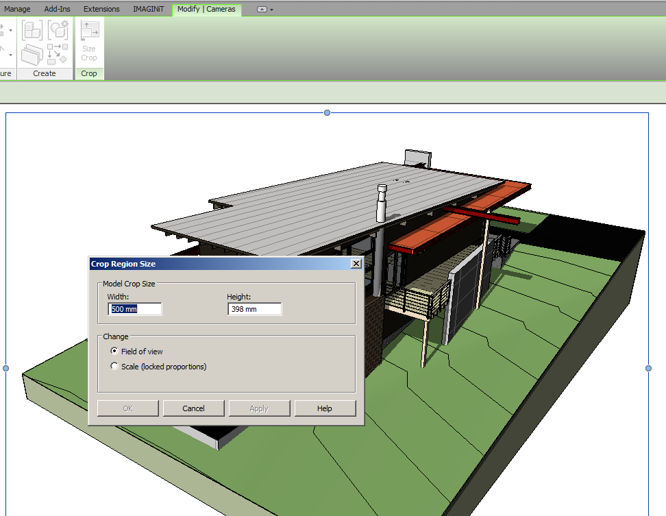

Mon, Jul 22, 2013 at 8:17:38 AM | Revit doesn't export high resulution images. why?
#9
Here - Crop size. Right click on the crop window.
Mon, Jul 22, 2013 at 1:23:54 PM | Revit doesn't export high resulution images. why?
#10
danezeq
Joined: Fri, Apr 5, 2013
78 Posts
5 Stars: 1 Votes
As much as i know this windows is reachable only when you deal with 3d camera view.
I deal with a regular PLAN VIEW.
