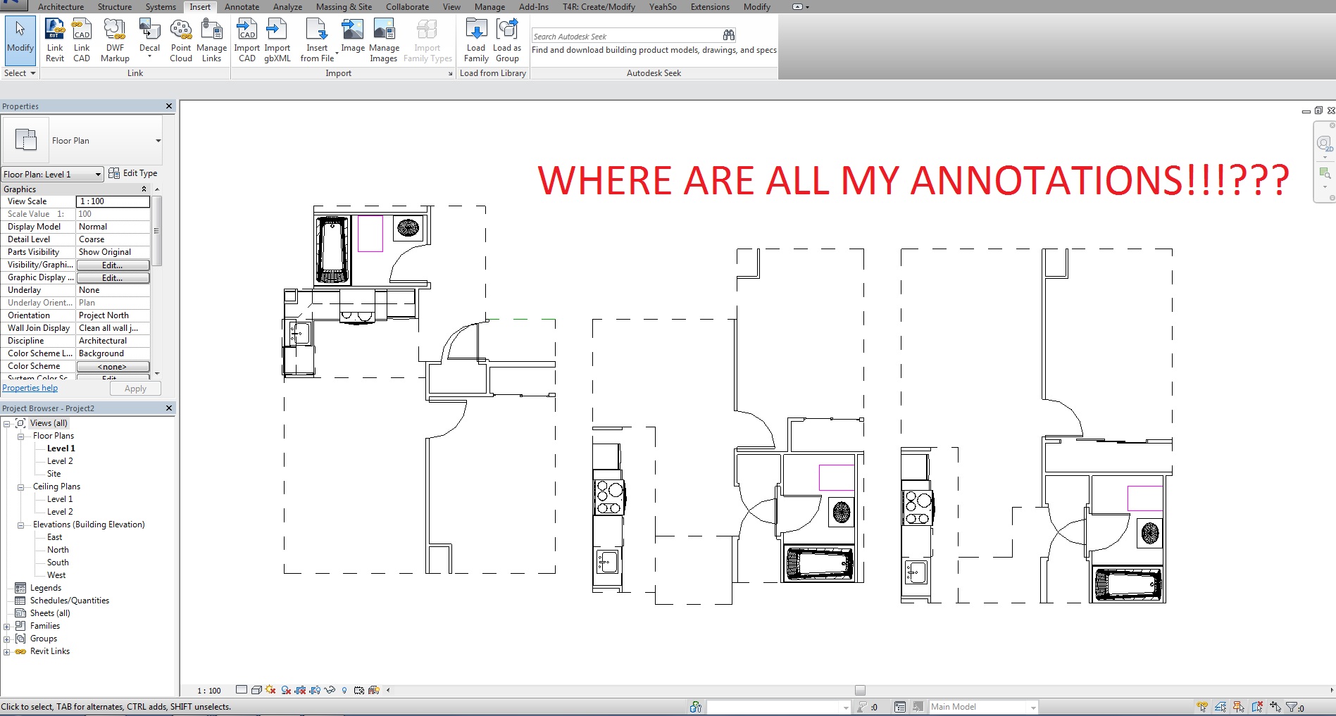

Hey guys,
Im working on a hi-rise project, created the units in seperate files, now linking them into the main file.
what freaking me out is the linked files doesnt show any of the annotations!!!!
any idea on how to show them?
Thanks

Go to VG and make sure that all of the annotations are on for the linked file.
Fri, Jun 14, 2013 at 2:23:11 PM | WHERE ARE ALL THE ANNOTATION GONE?????
You have to link a view if you want more than grids and levels.

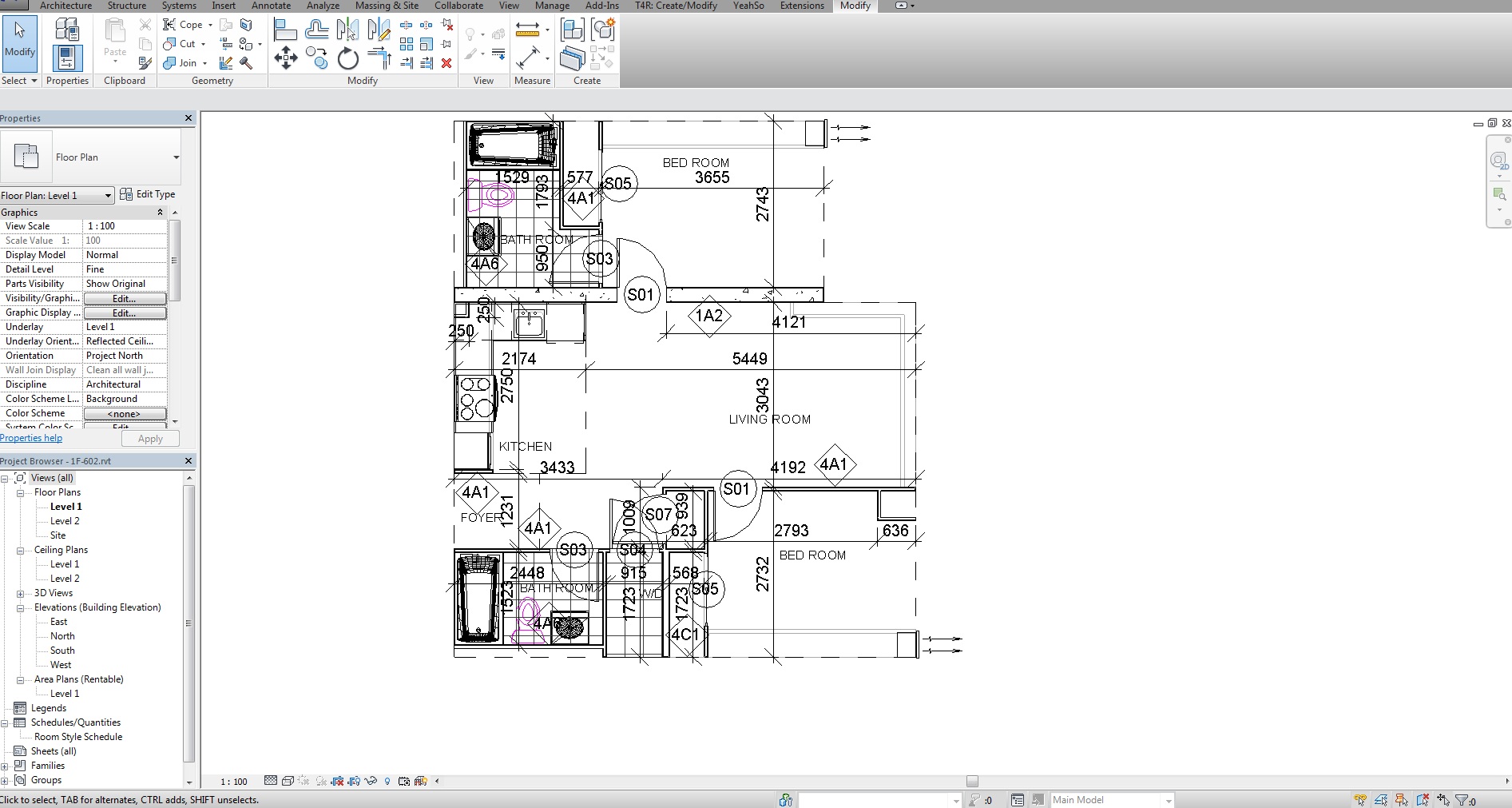

I have checked all the VG check marks, all of them are on!!!!

Quoting WWHub from 2013-06-14 14:23:11
Thank you my friend, i just did it.
But what a non convinient feature in Revit!!!
