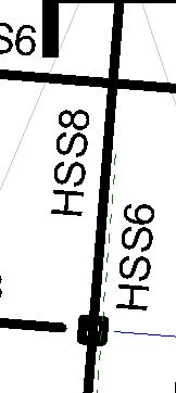

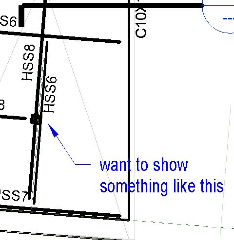

I have two beams in my model that are vertically aligned. I want to show both beams in plan. I want to offset one withou really offsetting it in the model. I thought I have done something like this before but can't remember how I did it. Symbolic lines, maybe. I don' know. Can anyone help me out?

If its just the one beam I wouldn't waste my time trying to fool with symbolic lines, I would just use a detail line if you need to see it in that view.
